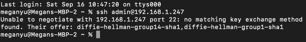

Hi I tried to follow your instructions above but I ran into an issue accessing the Ruckus:
Screenshot 2023-09-16 at 10.49.33 AM.pngI restarted the router and the rukus switch and still got the same message.
