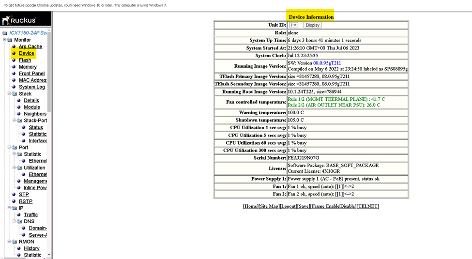

Hi @lovebirdsoffl
As per the screenshot you shared, the RUCUS ICX-7150-C12P Switch seems good on the Unleashed.
Could you please uninstall and install the Unleashed app and try to log in once again? Please make sure you are connected to the RUCKUS Unleashed Wi-Fi network when you try to log in on the Unleashed Application.

Hi @lovebirdsoffl
Could you please login to the RUCKUS ICX-7150-C12P Switch and share the information as shown in the below screenshot?

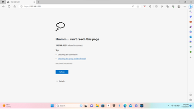

Use IP Scan and try to browse your ICX-7150-C12P Switch IP address on a web browser. As described in the below guide.
https://0.0.0.0 or http://0.0.0.0 (IP address of Switch. 0.0.0.0 is just as an example)
Please help with the above queries and let me know if you have any queries in this regard.
This is what I got when I tried that.
Hi @lovebirdsoffl
As mentioned in the previous post also try http://192.168.1.251 in HTTP form.
If that doesn’t work, could you please share a screenshot of the IP Scan Result?
