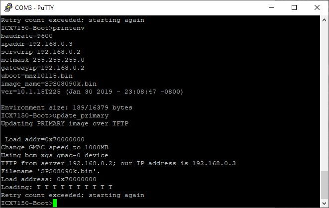

07-15-2023 03:47 PM - edited 07-15-2023 03:47 PM
Hello,
I have followed all of the steps for the Software recovery up until the 'update_primary' command.
After I input that command, I get a message, "Retry count exceeded; starting again"
What do I do from here?
