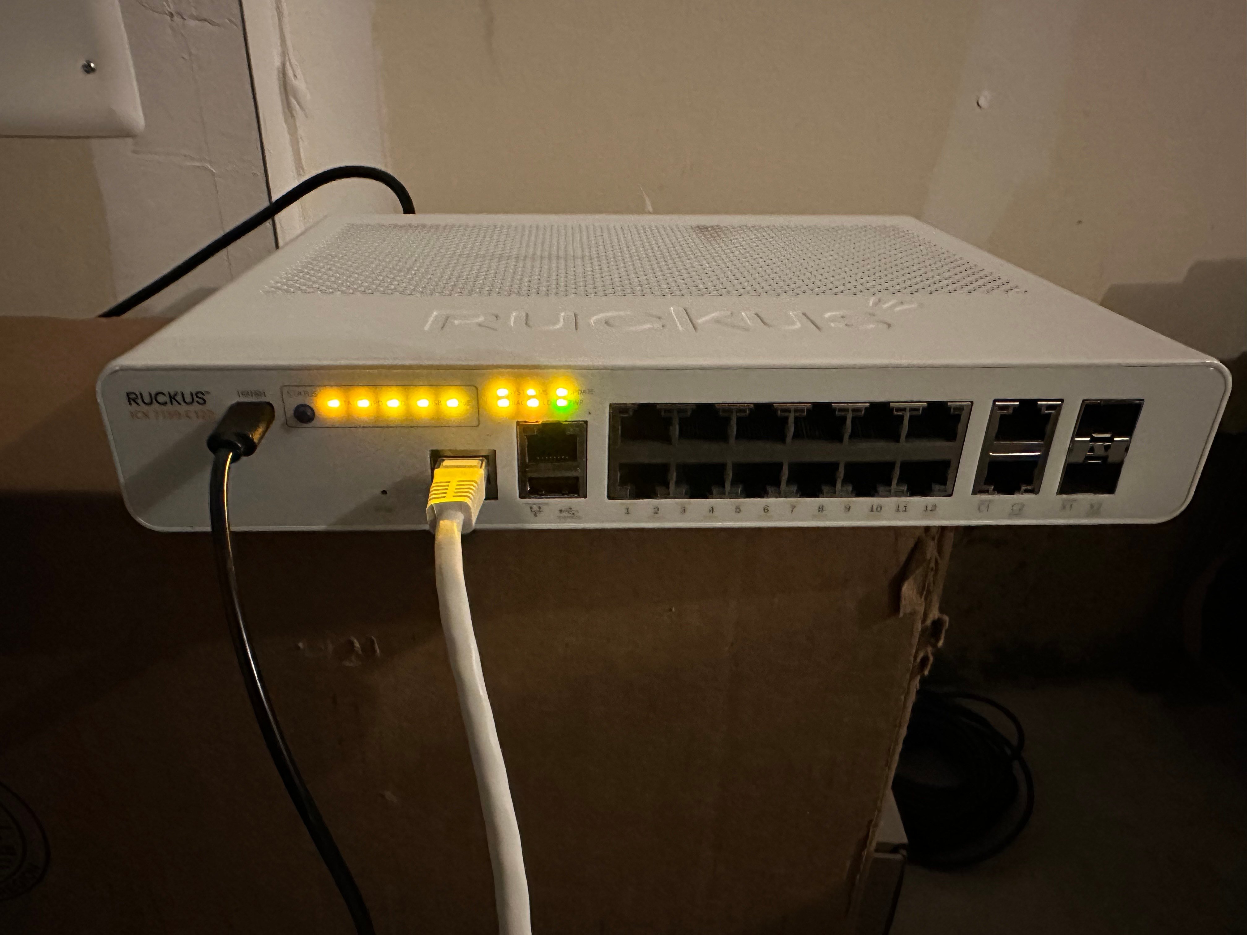

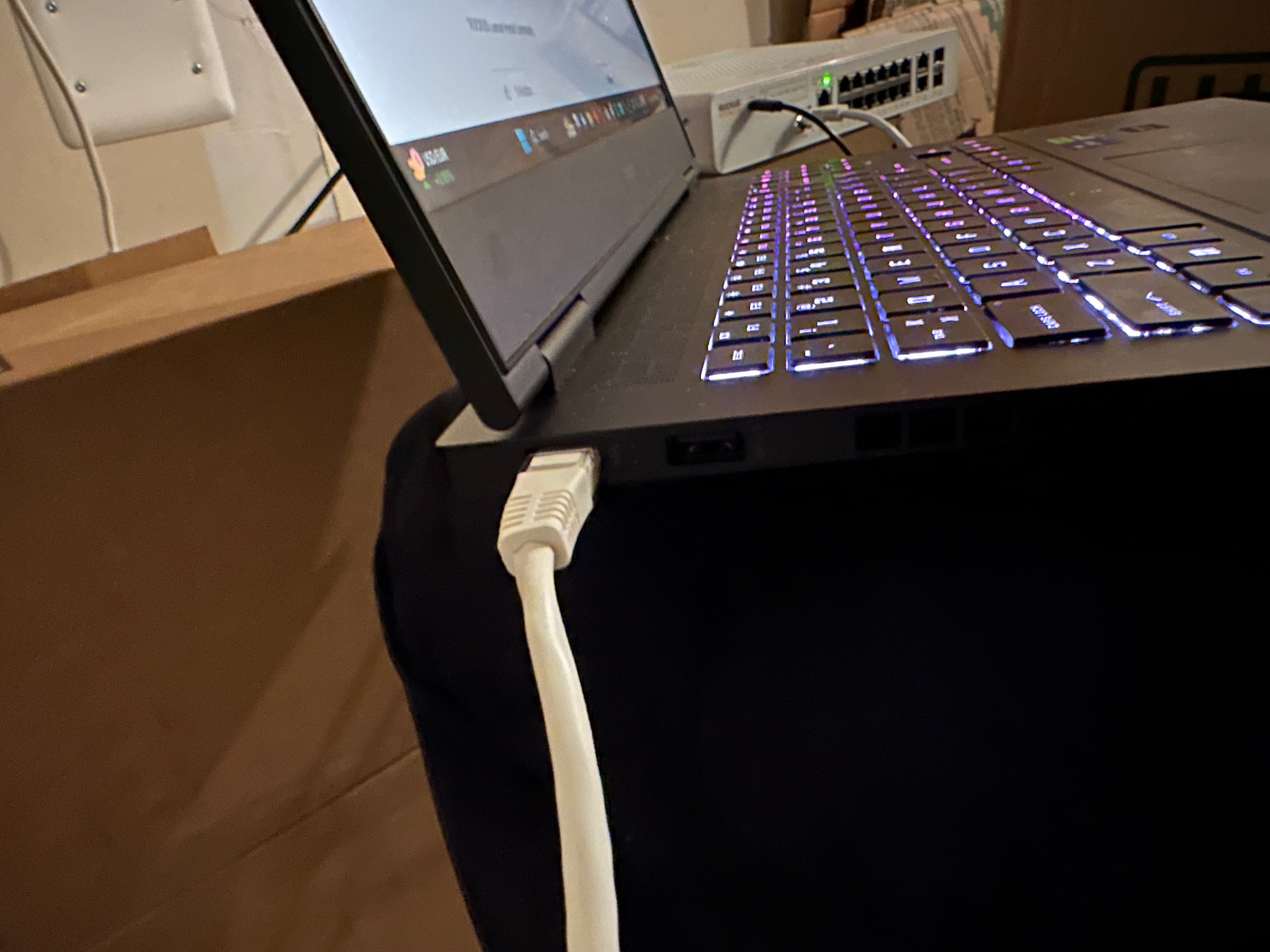

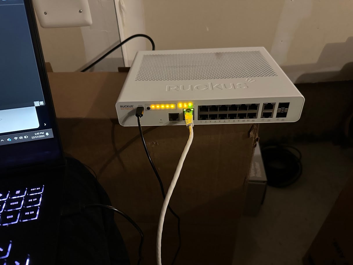

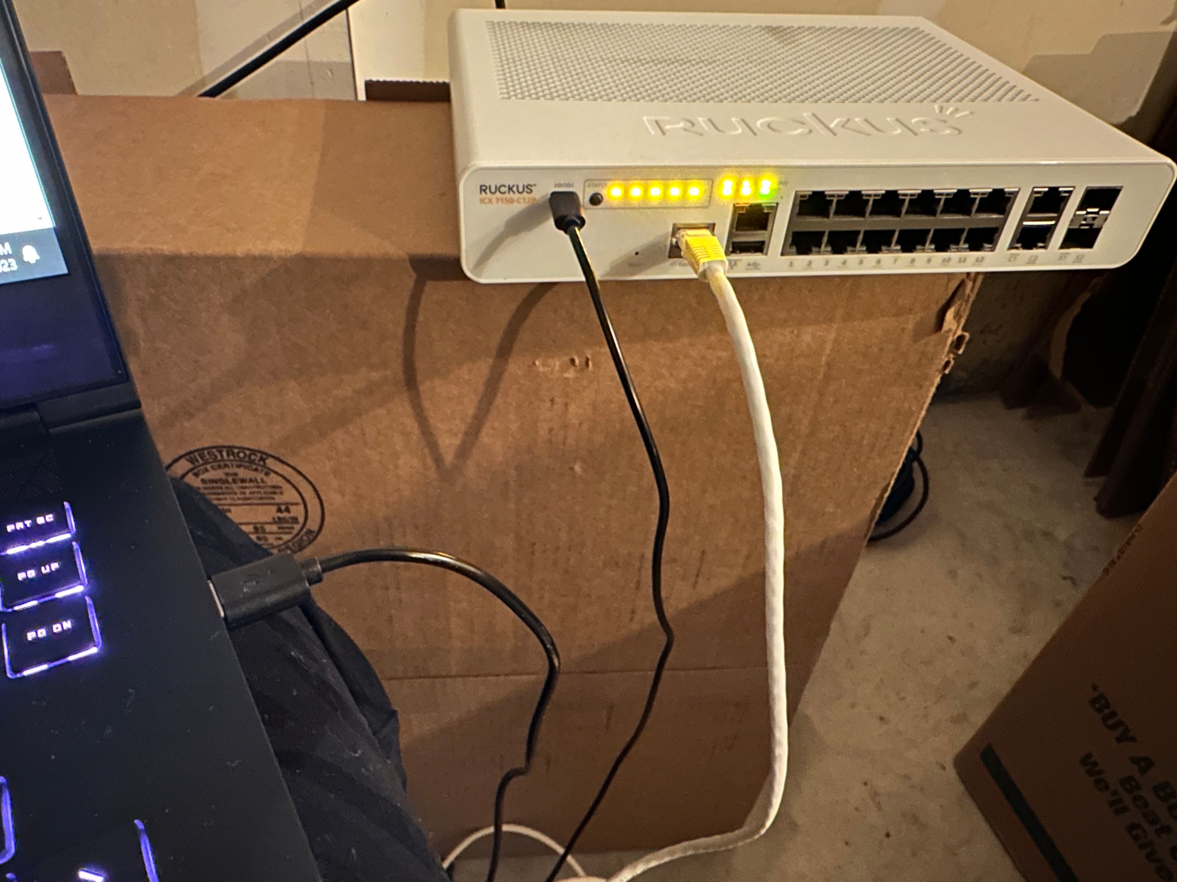

I have thoroughly exhausted all options regarding my issue, to include resetting the switch dozens of times using the hard reset instructions here: https://community.ruckuswireless.com/t5/RUCKUS-Support-for-Lennar-Homes/How-to-perform-a-Software-re... and also the instructions given to another user with the exact same issue here: https://community.ruckuswireless.com/t5/RUCKUS-Support-for-Lennar-Homes/Unable-to-follow-steps-in-So....

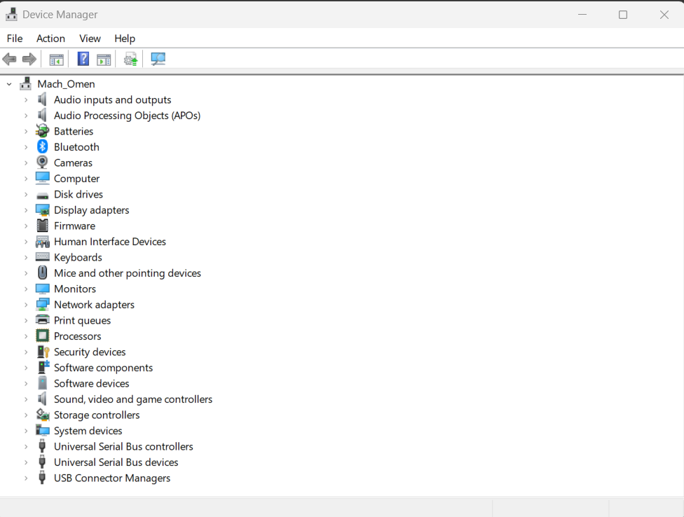

Whenever I try to access the switch via PuTTY, I cannot establish a connection because the COM port on my laptop isn't recognizing the device. I am using a USB-C to USB connection, as recommended by the above articles and I have already tried both PORT 15 and PORT 13, per the above articles to troubleshoot. I believe the problem is the same, where I will require RMA. Neither console ports are responding.
Please see the below pictures.

1. Start out by doing yourself a few favors to save a tremendous amount of time. You're going to need the following items: USB-C to USB-A cable (i ordered one off Amazon), RJ-45 Ethernet cable, and most importantly, USB DRIVERS for the USB-C to USB-A cable to actually communicate via COM port between the switch and your PC. Without the drivers, you will never see a COM port in your 'device manager' available. Download them here https://support.ruckuswireless.com/software/1414-brocade-ruckus-7150-usb-serial-driver-windows and refer to the pictures in this thread for help/step-by-step. Also disconnect everything from your switch and only have an Ethernet cable from the console port to your PC (see pictures above) plus the USB C cable connected from the switch to your laptop.

For console connection please check whether you have installed the software so the PC or Workstation can read the cable correctly. If not please install the software as mentioned below.
Make sure to download the zip drive for the file below & "extract all". Once it's extracted, run the file ,driver should be installed.
Link:https://support.ruckuswireless.com/software/1414-brocade-ruckus-7150-usb-serial-driver-windows
Link: silabs.com/developers/usb-to-uart-bridge-vcp-drivers?tab=downloads

Hello,
I downloaded the USB drivers you suggested and observed no change in the COM port. The LED lights are as follows: SYST = Orange. PWR = GREEN
No power is being supplied to any of the access points, no lights on for any of them.

If the switch has green and amber lights on SYS and PWR LED its means that the switch is stuck in boot mode issue. Also based on the images you have shared it seems like you are getting ping failed error while following the software recovery process.
