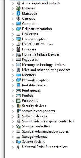

I am following the instructions in https://community.ruckuswireless.com/t5/RUCKUS-Support-for-Lennar-Homes/How-to-perform-a-Software-re... and when I get to the device manager, I do not see any COM# listed under Ports (COM & LPT). I tried adding legacy hardware in device manager and I get error code 34. I am unable to run putty, as I get an error. I think something may be wrong with the usb-c port on the switch, as I have tried several different cables. Other usbs connect to my laptop without issue.

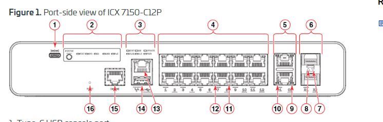

If you suspect your USB-C type port is not working on the Switch, please use an ethernet cable and connect to the other console port as shown in the below screenshot. Since there are two options to get console access from the Switch.
Once you connect the ethernet cable between your Switch and the laptop as shown above, please check the COM ports in the device manager. And share the screenshot of the same.

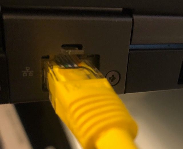

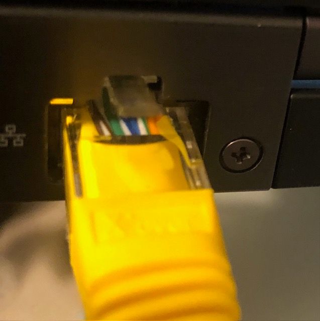

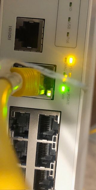

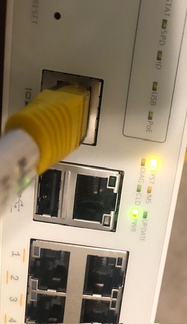

Port #15 (see diagram) is dead too. I verified this by unplugging the ethernet from my #15 and plugging it into #13 (see diagram). #15 did not register on my computer's end (picture included) but #13 (see picture) did. So Ruckus needs to replace this switch because #1 and #15 are the only way for me to perform a software recovery and both are DEAD. Please stop wasting my time and approve an RMA so When connected to #15 on switch and laptop.
Connected to #15 on switch
No connectivity from #15
Test to prove cable works, connected to #13 on switch and works. See lights are lit up.
Test to prove cable works, connected to #13 on switch and laptop and it works. See lights are lit up.
Diagram for reference, so you understand my references to #15 and #13can get back to having proper internet service, you are costing me money at this point.
