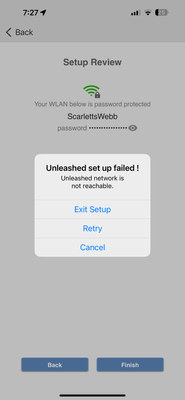

We purchased our home 2 months ago and it had the RUCKUS system installed - we’ve hard reset the system but it’s still connected to the previous owners internet which is no longer at the home. The homeowners before us said they unpaired and deleted everything but it wont allow us to connect. Can someone help us?

Ok I moved the cord and got farther than I have but I’m still not able to connect 😕

1. Are you currently attempting to factory reset the Access Points?
2. If not, and if you have an existing network, could you please confirm if you are able to log into the Web-based RUCKUS Unleashed system on a laptop?
You can access your Unleashed system using either the Master AP IP Address or by visiting https://unleashed.ruckuswireless.com/
3. Try to uninstall/install the Unleashed application on your smartphone and try to login.
Please verify and confirm these details. If you have any questions or concerns, please feel free to ask.
