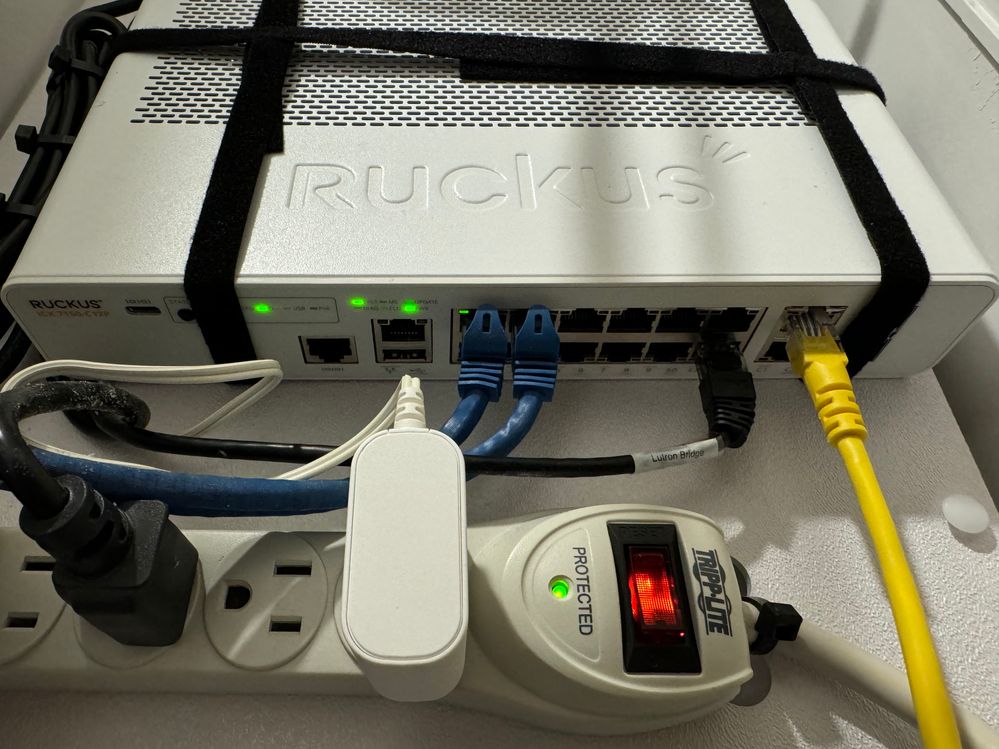

The lights on the switch are all green - they are system, power, and POE

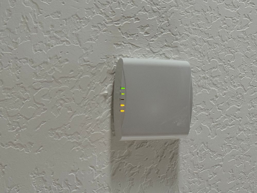

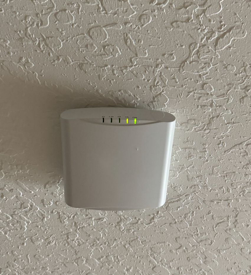

We have 2 access points - 1 upstairs and 1 downstairs. The one upstairs has 2 blinking green lights “CTL’ and “PWR” and the one downstairs has 2 amber lights on the left 5G and 2.4G and a solid green light under “CTL” and a blinking green light “PWR”

As per the light status of the RUCKUS ICX-7150-C12P Switch, they seem to be in a normal status.
As I see from the picture you shared, it seems like the ethernet cable which is coming from the ISP’s (Internet Service Provider’s) Router or Modem/Router combo is plugged into the wrong port on the Switch panel. It must be plugged into any 1 in-12 ports as shown in the below screenshot. Please unplug the ethernet cable and plug it into the correct port then reboot (unplug and plug from the power outlet) and try to connect to the Internet via Access Points.
