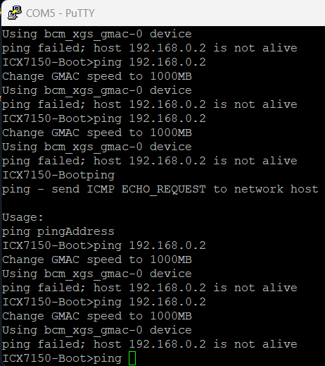

Experienced a brief power outage today, 4/24, around 3:45 PM PDT. Since then the RUCKUS switch (ICX7150-C12P) has been unable to reboot. APs are also down without any lights.
I attempted to perform a software recovery by following the instructions closely from the following post/URL: RUCKUS Forums - How to perform a Software recovery on an ICX7150 s... - CommScope RUCKUS Community F...
When I reached the step to ping 192.168.0.2, I received a "ping failed; host 192.168.0.2 is not alive." I went back and double-checked each step to ensure I did not make a mistake. I also tried using different equipment (laptop/desktop, ethernet cable, etc.) but to no success.
PuTTY terminalPuTTY terminal
In researching my issue, I was able to find another community's member's post below and it appears I am running into the same issue and that a possible RMA may be required.
URL: Solved: RUCKUS Forums - ICX7150 stuck in boot mode - "is not alive" when t... - CommScope RUCKUS Com...

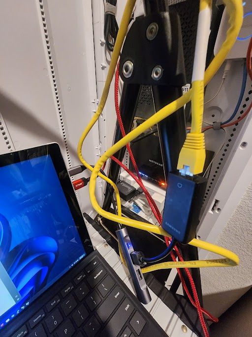

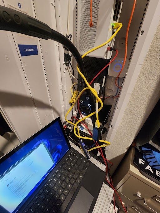

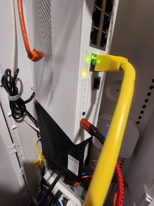

Here are some additional photos of the setup:
Laptop - Red USB-A to USB-C cable (connecting to Switch) and Ethernet port and yellow ethernet cable (connecting to Management Port on Switch)Laptop - Red USB-A to USB-C cable (connecting to Switch) and Ethernet port and yellow ethernet cable (connecting to Management Port on Switch)Overall - Laptop & SwitchOverall - Laptop & SwitchSwitch - Red USB-A to USB-C cable connecting to console and yellow ethernet cable connected to Management PortSwitch - Red USB-A to USB-C cable connecting to console and yellow ethernet cable connected to Management Port
Please advise.

mmmaynard
Hi Jayavidhya,
Thank you for your response and suggestion. I really appreciate you taking your time in reviewing my issue.
I am extremely happy to report that disabling the Windows firewall did the trick! I was able to proceed with the system recovery process. And I was also able to upgrade both primary and secondary from 08090k to the recommended 08095gufi.
Things are running smoothly so far. I am happy that a solution was found without having to RMA the switch.
Take care and have a wonderful rest of your day!
