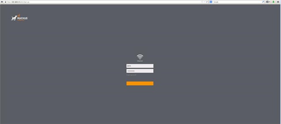

From the response you shared, it seems that the Ip address you used to login to the Unleashed dashboard appears to be of ICX-7250 Switch and not of the Access point..
Once you access the IP address from the IP Scan results,(Please share the screenshot of the IP scan results) to confirm that the IP address is associated with the AP, you should observe the Unleashed Dashboard, which should be visible upon accessing the appropriate IP address, as illustrated in the screenshot below.

Could you please try using a different working Ethernet cable with the non-working access point. The current cable might be faulty
Also, please try to use  the IP Address of the Non-working AP and check if you are able to access the Unleashed dashboard.
Once you see the above dashboard, please try to use the login credentials and check if you are able to access the dashboard.
