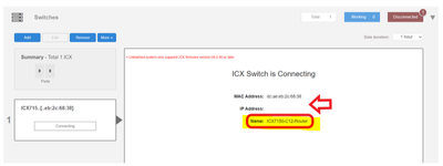

Base in your description, it looks like your Switch (ICX7150 Switch) may be booting from the wrong partition, let me add the guide to fix the issue.
Note: if you have access to the Unleashed Dashboard or APP, and if the Switch can be viewed from there, it may look like the following Image, ICX7150-C12-Router instead of ICX7150-C12-Switch.
