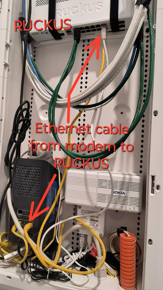

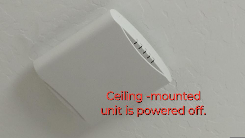

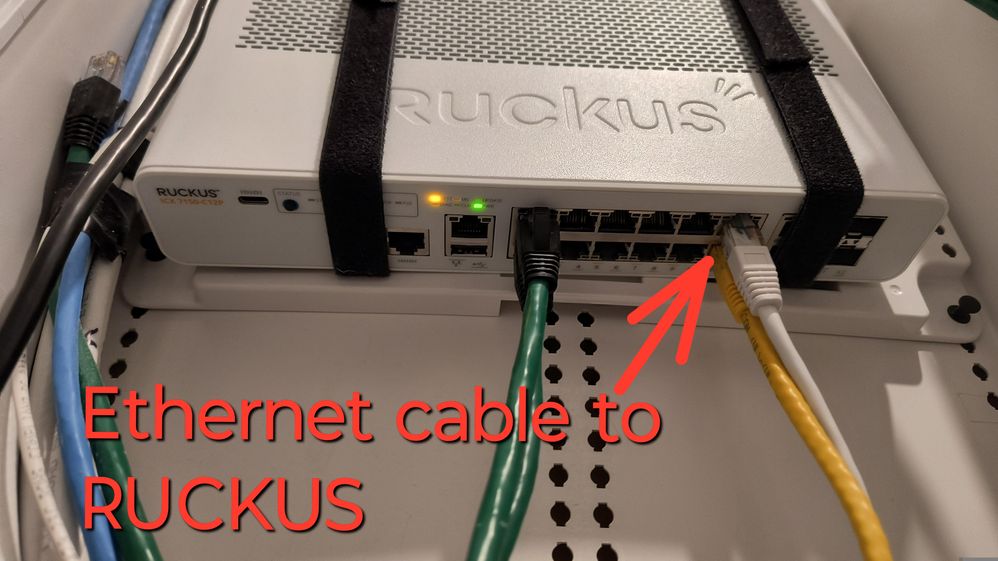

The Ethernet cable from the modem to the RUCKUS ICX 7150-C12P has no flashing green light. Turns out Lutron doesn't work at all. Two devices mounted on the ceiling (for smart home use) are also completely switched off.

From the response and the pictures you shared, I understand that the status lights on the Switch is Amber and the PWR light is Green which means that the Switch is stuck in the boot mode.
Please follow the below RUCKUS Lennar Knowledge base self-help article which will help you to fix the issue when the Switch is in boot mode.
https://community.ruckuswireless.com/t5/RUCKUS-Lennar-Support-Knowledge/Fixing-RUCKUS-Switch-with-an...
Please follow the process as explained in the article and let me know if you have any queries in this regard.
