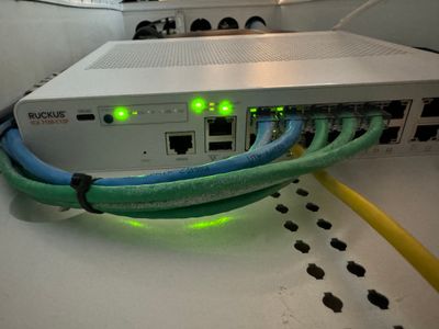

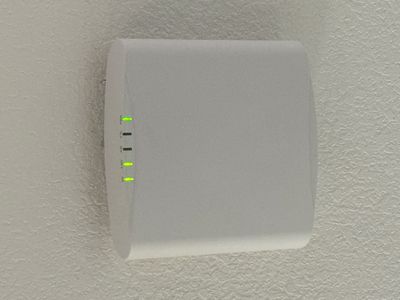

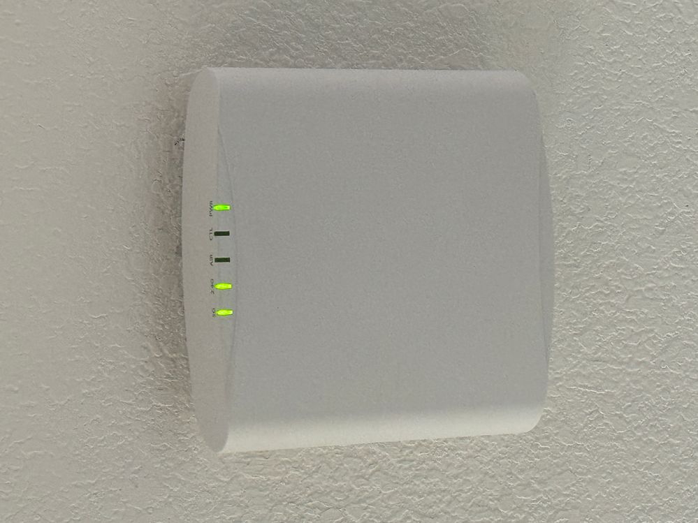

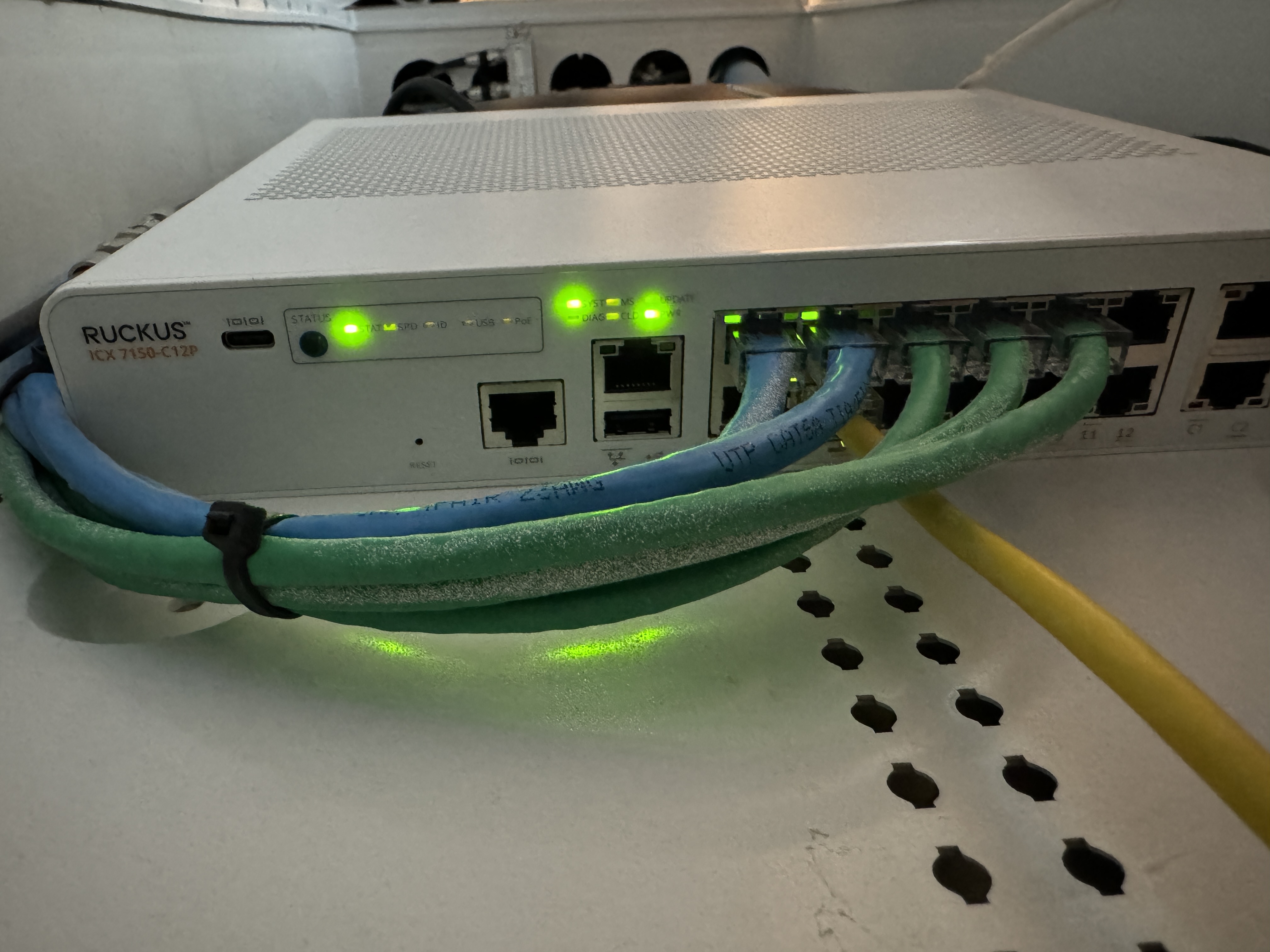

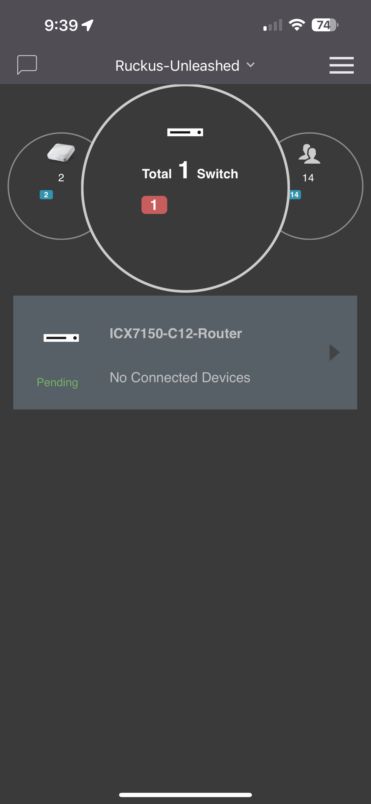

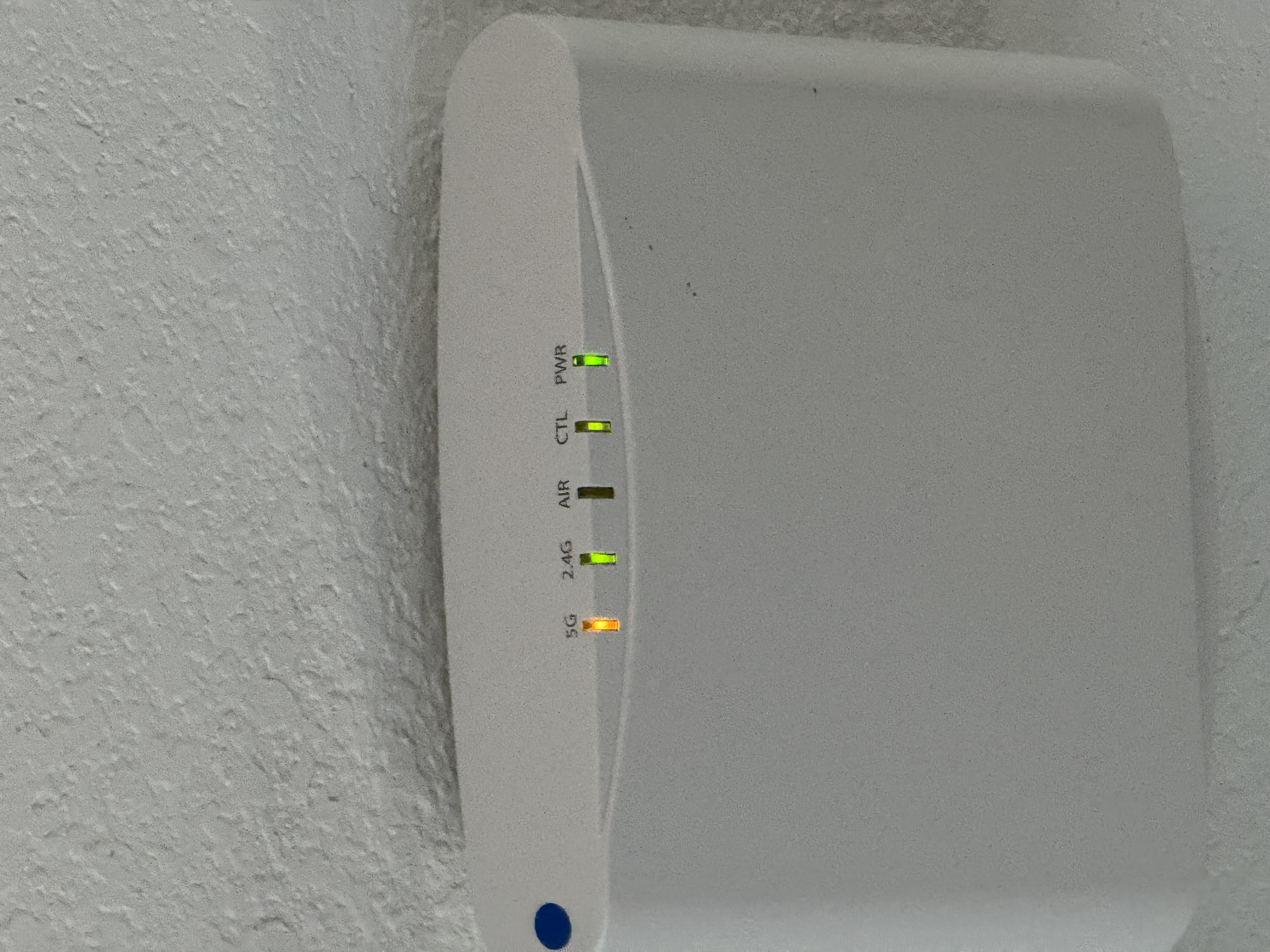

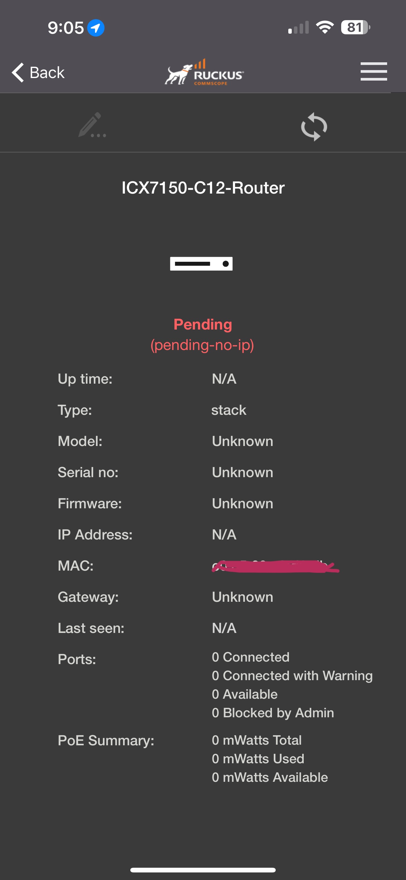

We have not been able to use anything WiFi enabled towards the front of our house for the last few weeks following a power outage.
I have unplugged, reset, upgraded everything I can think to get it to start working again but nothing has worked.
I saw a thread about my same issue but it was unresolved.
I do not have a laptop that I can use to hook up to the router. So that’s not an option to trouble shoot.
I found my IP address and tried logging in but none of the admin log in/password combinations allow me to get in to try to change what the thread was saying to do.
here are some pictures of what I’m seeing.

From the below screenshot you shared, I understand that the Switch is booted up on the secondary partition which is running on Routing code (SPR)
I understand that you does not have a laptop to connect to your router. Kindly requesting you to arrange a laptop to fix the SPR issue.
The Switch should run on the Switching code (SPS) to avoid these issues for Lennar home users. Due to a power outage/power spike, the Switch boots up on the other partition which may be running on a ‘Routing Code’ results in causing this issue.
Please follow the below RUCKUS Lennar Knowledge base self-help article which will help you to fix the issue when the Switch is running in the Routing code.
Please follow the process as explained in the article and let me know if you have any queries in this regard.
