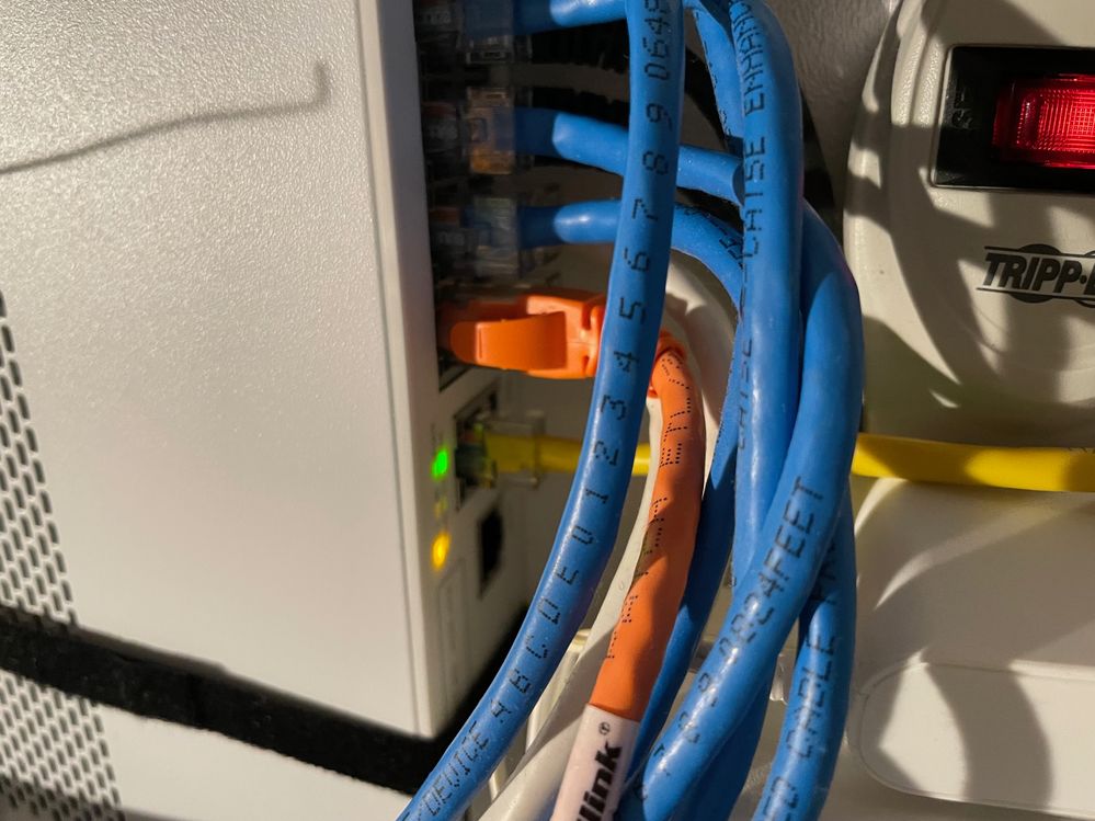

First the syst light is yellow and PWR light is green (rest of the light are off) and the access point is not power up.
I try to reset the swith by turn off the power, use a pin to press the reset button, and turn the power back on. Now all the lights are flashing yellow except the PWR is green. The first time I wait about 10 minutes, and the flashing is never stop. I turn off the power and turn back on, back to the first step syst light is yellow and PWR light is green. I tried again to reset the swith, now the lights are flashing about half hour and never stop.

Could you please see the picture? I already tried everything I can. Can you just send me a new one and I will return the old one to you?
Hi @yuwenchen
Please take out your RUCKUS ICX-7150-C12P Switch, unplug all the ethernet cables from the Switch only connect the Power cord and 2 software recovery cables.
As I see you have only connected an ethernet cable between the Switch and the laptop.
Please note, we must use ethernet cable (both ends RJ45 plugs) and USB to type C cable both together as described in steps 2 & 3 in the guide link.
Please follow the above steps and perform the software recovery process once again. Let me know if you have any queries in this regard.
