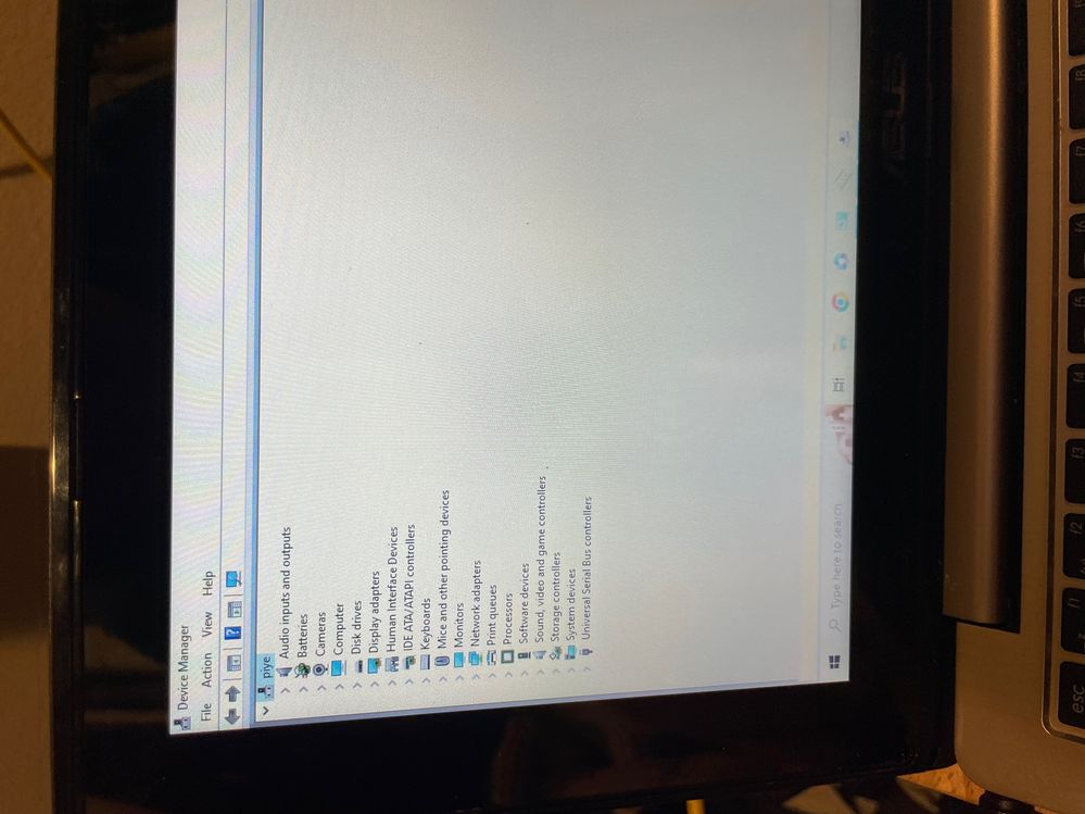

Could you please see the picture? I already tried everything I can. Can you just send me a new one and I will return the old one to you?
11-22-2023 11:36 AM
Hi @yuwenchen
Please take out your RUCKUS ICX-7150-C12P Switch, unplug all the ethernet cables from the Switch only connect the Power cord and 2 software recovery cables.
As I see you have only connected an ethernet cable between the Switch and the laptop.
Please note, we must use ethernet cable (both ends RJ45 plugs) and USB to type C cable both together as described in steps 2 & 3 in the guide link.
Please follow the above steps and perform the software recovery process once again. Let me know if you have any queries in this regard.
