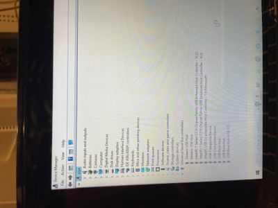

The laptop is connect to the Switch, but I don't have the Ports (COM & LPT) from my device manager. Could you send a new switch to me and I send the old one back to you? It is taking too long, and there are a lot of blocks. I really need it up and running.

Could you please share a picture showing the software recovery cable connections between the RUCKUS ICX-7150-C12P and the Laptop?
