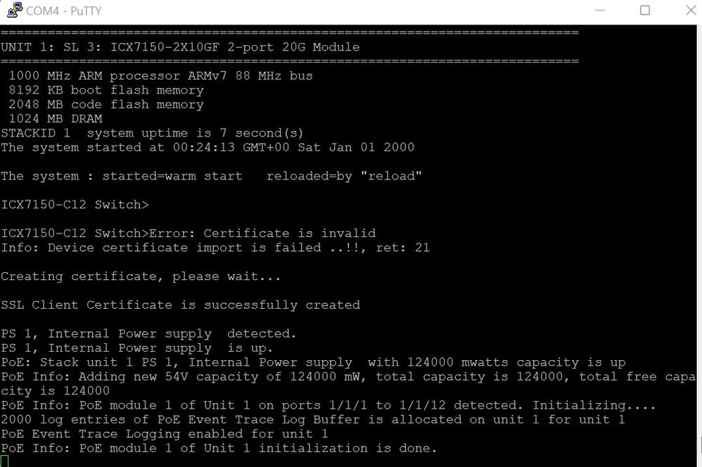

home_auto
I have attempted the following steps but before it completes, it gets hung up on the following line: PoE Info: PoE module 1 of Unit 1 initialization is done.
ICX7150-C12-Switch enable
ICX7150-C12-Switch config terminal
ICX7150-C12(config) tftp disable
**restart the switch and hit b until boot option**
ICX7150-C12-Switch no password
ICX7150-C12-Switch boot
config t
username admin password password
wr mem
exit
Reload
Are you sure? (enter 'y' or 'n'): y
