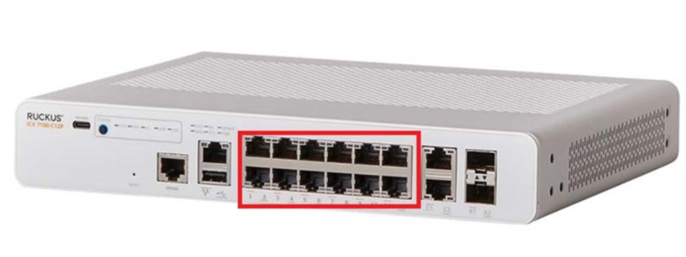

Could you please unplug the ethernet cable of the Access Point and plug it into any 1 in-12 ports (as highlighted in the below screenshot) of the RUCKUS ICX-7150-C12P Switch?
