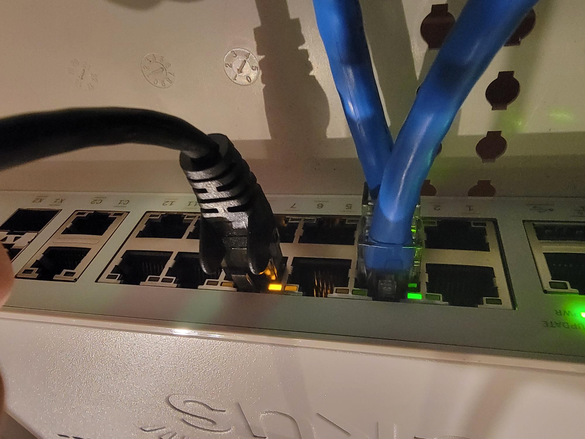

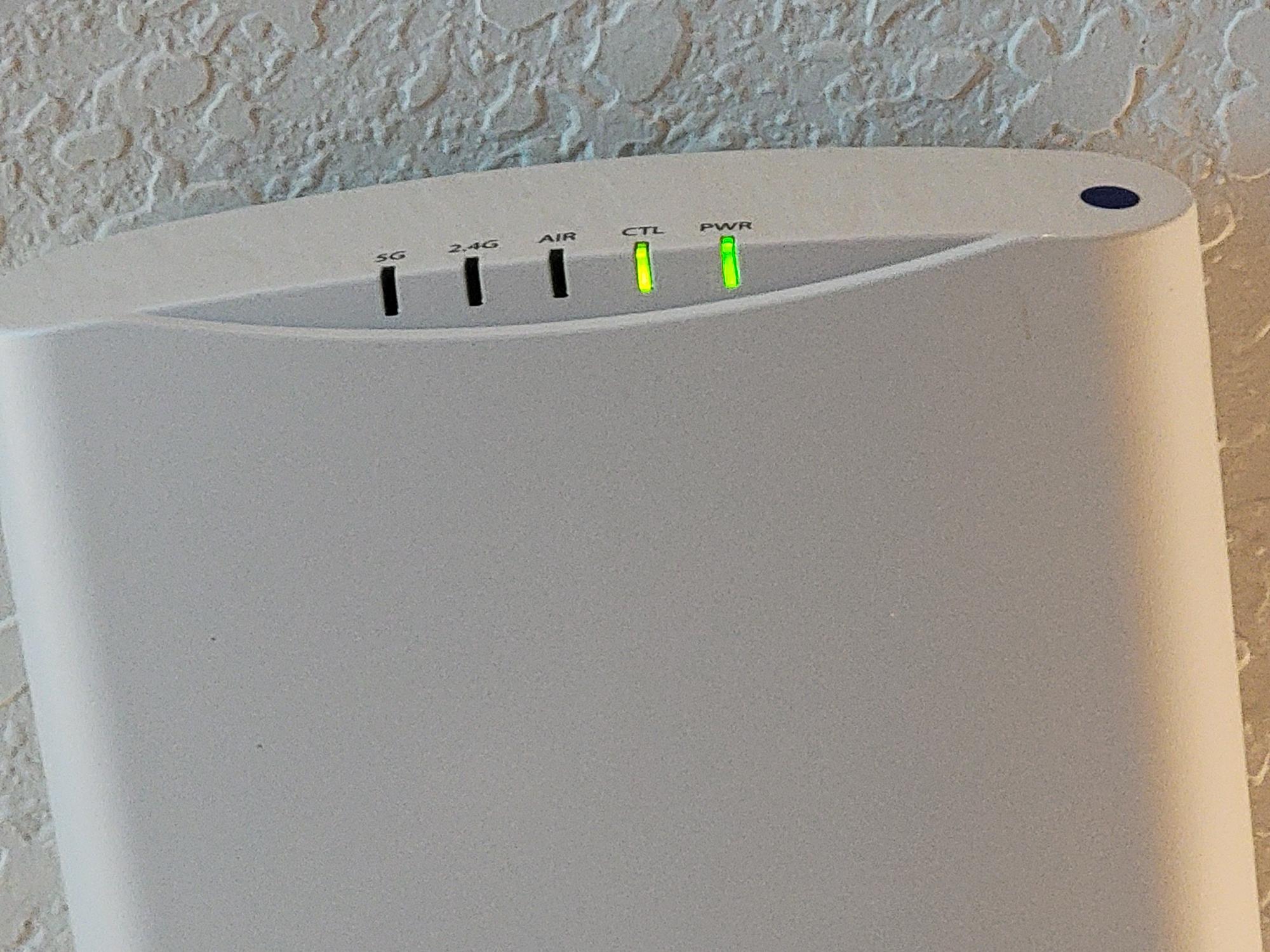

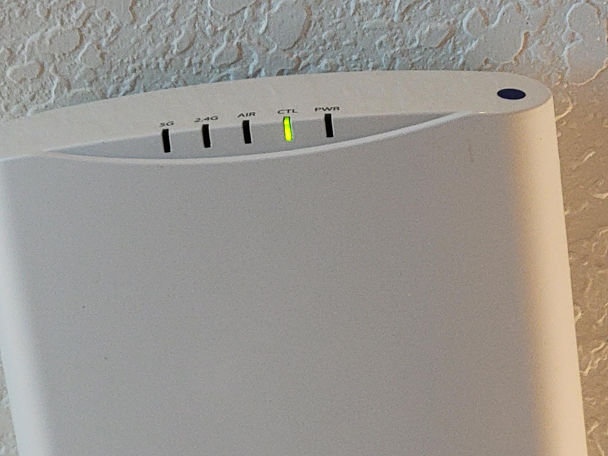

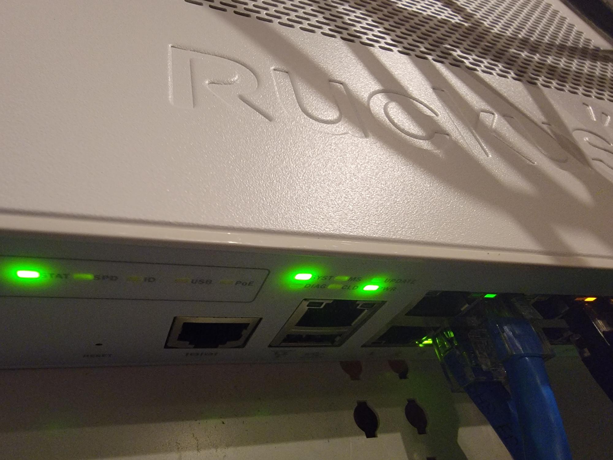

We checked the Ruckus switch and based on all the forms I read, there were no issues with lights by the ports (Syst and Pwr lights are solid green as well as the lights next to the two AP ports).
We noticed the 2 APs itself had flashing power lights and either a solid or flashing CTL light. After doing numerous restarts to the power cord connected to the Ruckus we are still not able to connect to the WIFI. I've been reading a lot of the forums and previous posts and have attempted many different things but cannot figure out the issue.
(Please note both of these AP photos are of the same AP. The second AP has flashing green lights for both the Pwr and the CTRL lights, which are not shown).

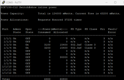

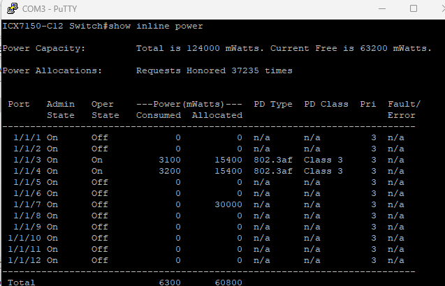

2) Thought it was the PoE's not On and working so I connected to the Command Line through USB-C and was able to see that all of the ports were "On".

1. Disconnect the Ethernet cables from the Access Points and the Internet Service Provider’s (ISP) Router that is currently connected to the RUCKUS ICX-7150-C12P switch port.
2. Reconnect the Ethernet cables to the other available 1-in-12 ports, as highlighted in the screenshot below. (Refer to the screenshot below)
After making this change, please observe the behavior of the Wi-Fi and AP if it works and let me know the results.
If that doesn’t work, please share with me the Command Line output of the mentioned commands.
show version
show flash
show inline power detail
show interface brief

Switching the ports did not help. The two AP ethernets are solid green in the new port locations. The only difference is that the yellow light next to the ISP before is now flashing green in the new location.

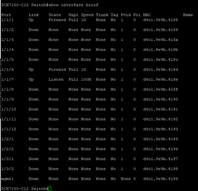

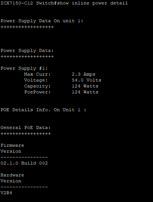

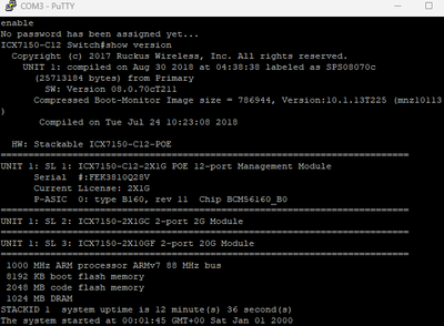

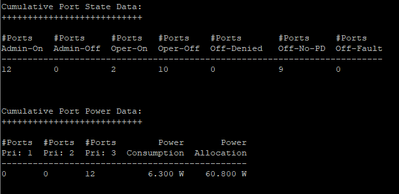

Here are the screens after each command above:
show version:
show flash:
show inline power detail:
show interface brief:

When connecting the laptop with the ethernet cord to the RUCKUS switch, there is no internet connection. The light on the RUCKUS switch port is solid green.
