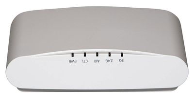

Hi @Olaoluwa035
Basically, the yellow light means that there are not clients connected on that specific Radio (5G or 2.4G) that depends where is the yellow light on.
This does not mean that the Access Point is broken or damaged.
Here is the meaning of each light on the Wireless Access Point
https://docs.commscope.com/bundle/unleashed-200.9-onlinehelp/page/GUID-19D4261B-D10B-4DE3-B63A-3498F...
Yellows light 2.4G: Radio is up, no clients are connected to the 2.4 GHz radio.
Yellows light 5G: Radio is up, no clients are connected to the 5 GHz radio.

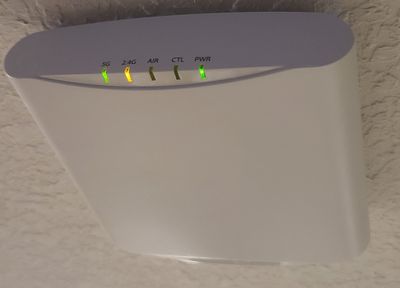

Hello Vasquez,
I after my last message, I went back to the wifi and I found the wifi name in available wifi on my phone. So I went back down to the switch enclosure where the Username and password was and I was able to log into that wifi. Currently I'm using the Lennar wifi and only one AP is activated, the middle one, I have 3 floors.  See image, the 5G is active and I'm currently using it. My thought was that all AP will be connected.
 Even when I log into the unleashed app, it shows only the middle AP connected, the rest shoes the orange color on both the 5 and 2.4G.
How do I get everything connected?
