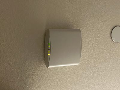

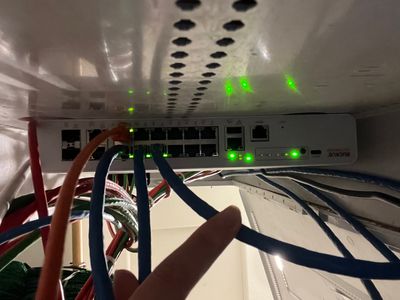

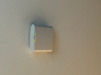

I have three APs throughout the house and 1 switch (Ruckus ICX 7150-C12P). All of the cables to the switch show a green light. For most of the day yesterday, the power lights to all APs were green, and the CTL was off completely. This morning, the CTL light for the master AP and 1 other AP is yellow, but for the third AP it is off.

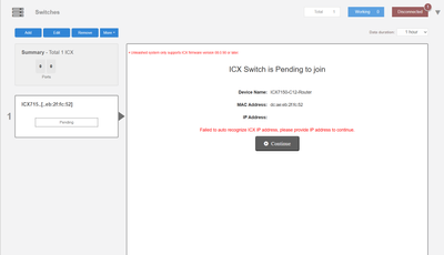

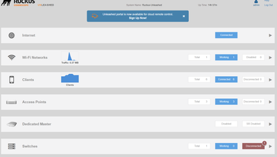

My unleashed dashboard shows that the switch is disconnected. I spent most of yesterday following instructions to reconnect it, but am unable to do because I cannot find the switch IP--and, I already tried locating the current switch IP using these instructions: How to find the IP Address of the RUCKUS Devices (Switch and APs) using IP Scanner free applications...

Here are some pictures of the devices in their current state:

Based on the details you provided and the screenshot you shared, it appears that your RUCKUS ICX-7150-C12P switch is experiencing intermittent internet connectivity issues.
From the pictures light status and cable connections of the RUCKUS ICX-7150-C12P Switch and Access Points seems normal. However, I see the screenshot you shared, your RUCKUS ICX-7150-C12P Switch is booted on the SPR Code (refer to the below screenshot) causing these issues.
For a resolution, please consult the RUCKUS Lennar Knowledge Base article available at the following link:
https://community.ruckuswireless.com/t5/RUCKUS-Lennar-Support-Knowledge/Fixing-RUCKUS-ICX-7150-C12P-...
This resource provides a detailed troubleshooting guide for addressing the SPR code issue.
