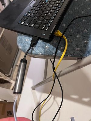

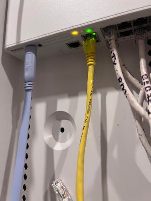

But I am getting stuck at the step identifying the "COM#". It appears maybe there's a different console cable I need to use? If it's the console cable problem, can you recommend one that I can buy to proceed with this process?

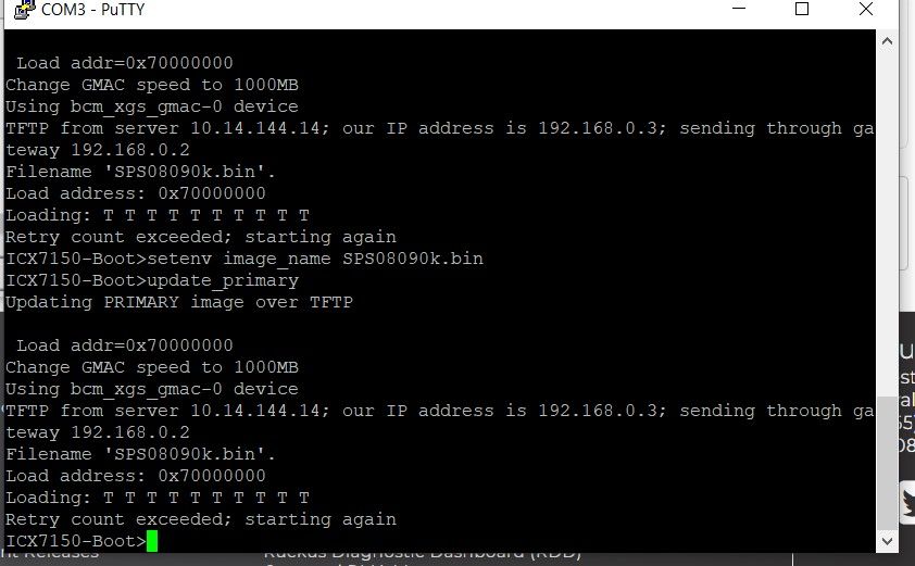

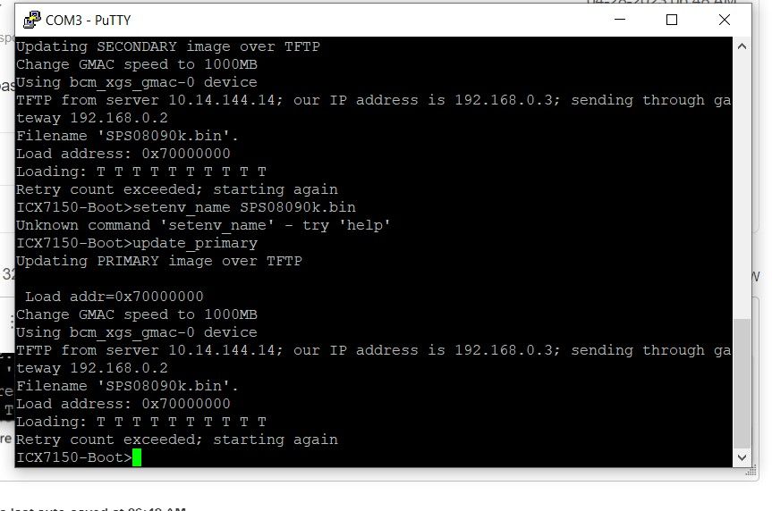

Seems like during the software recovery process it’s not fetching the image which you downloaded, due to which there is an error “Retry count exceeded; starting again”.
I see the files you selected are in the .jpg extension (please refer to the below screenshot). It should be in the .bin extension by default when you download it. Please download the firmware file of 08.0.90k once again from the support portal and try again. (Please follow step 5 from the guide)
Please check and make sure you have created a separate image folder for 2 files mnz10115.bin and SPS08090k.bin as highlighted in the screenshot below. (Folder name is ‘Upgrade’ in below screenshot example)
Also please make sure, TFTP is correctly configured with the correct folder (folder of 2 files mnz10115.bin and SPS08090k.bin) and Server interfaces as marked in the below screenshot as an example.

The console cable I am using is a combination of the following I purchased off Amazon:
https://www.amazon.com/dp/B0774JV2QQ?ref=ppx_yo2ov_dt_b_product_details&th=1
https://www.amazon.com/dp/B00M77HMU0?psc=1&ref=ppx_yo2ov_dt_b_product_details

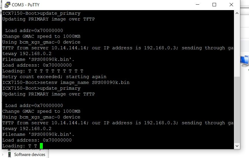

04-28-2023 06:48 AM
I successfully get past the console cable portion, but am now getting stuck at the "update_primary"

Sorry disregard previous image. This is the correct image. I keep getting a retry count exceeded.
