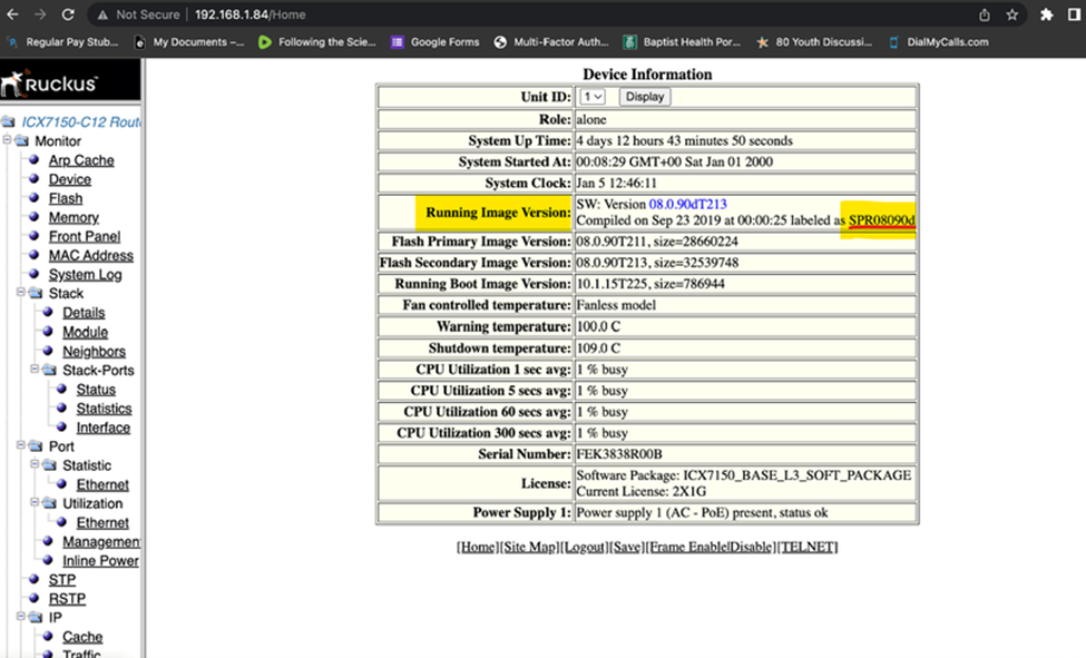

From the response shared, I understand that you are able to login to the Switch using the web browser.
If you can log into the Switch on the web browser, please check the details highlighted in the screenshot below.
Please share the  screenshots if stuck at any step or error (if any) and let me know if you have any queries in this regard.

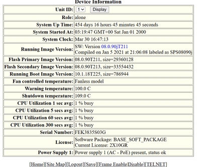

Please find the screenshot.
