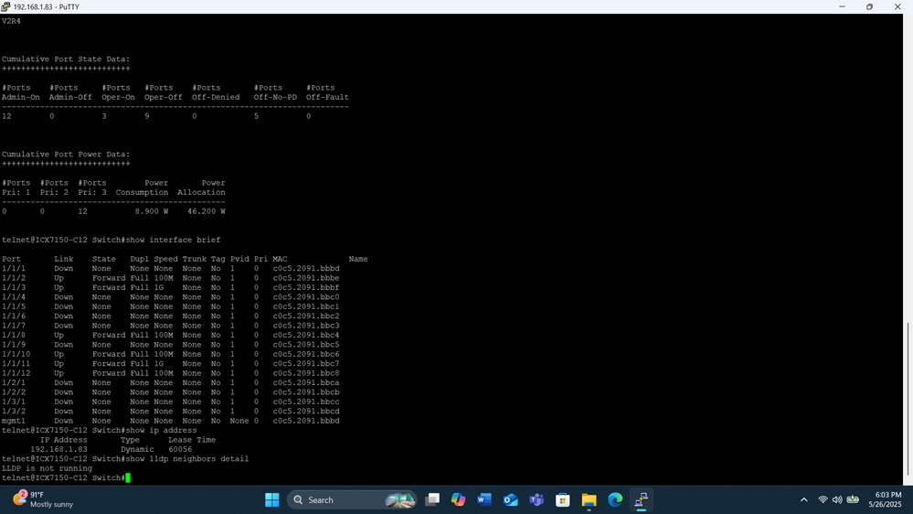

I went through all the commands.  Yes, the responses to the commands were lengthy, and I have no idea what they mean.  When I entered the last command: show lldp neighbors detail, the response was LLDP is not running.
Again, sorry I cannot do a screenshot.  Hope this gives you what you need.

From the response shared, I understand that you are getting an error message “lldp is not running” as an output of the command.
However, we need the output of the remaining commands to assist you further.
Please share a screenshot of the commands that we shared in the previous post.

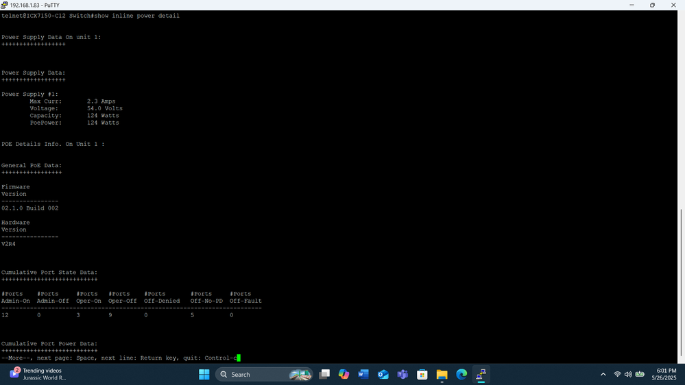

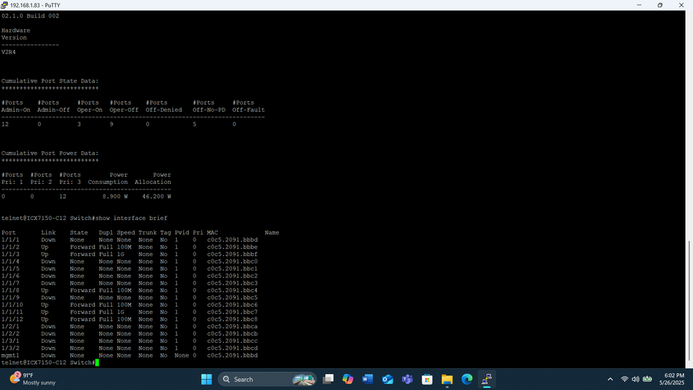

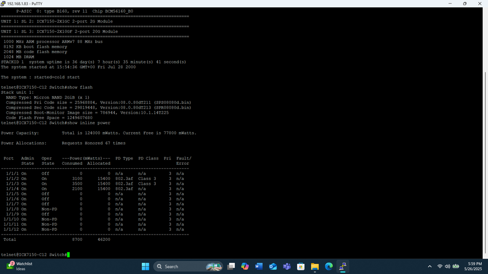

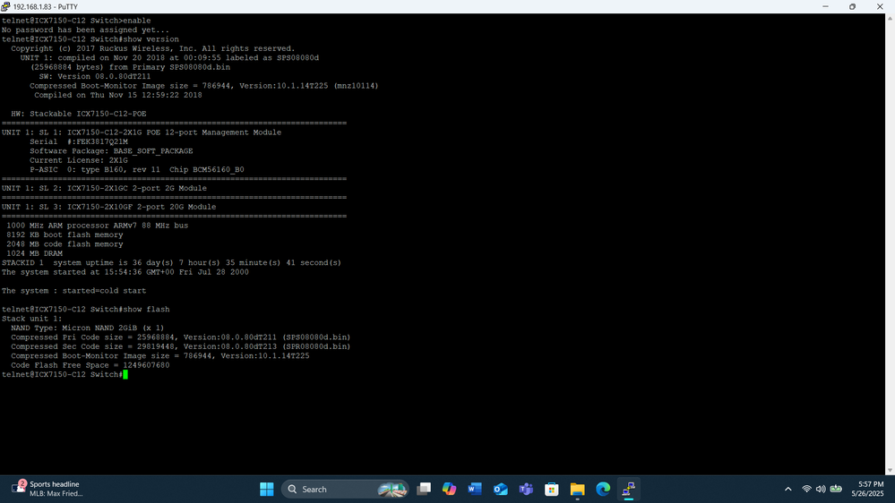

Attached are the screenshots of the command line outputs using Putty.  I hope I got everything you need to see....  Thanks MarkG
Screenshot (3).pngScreenshot (5).pngScreenshot (6).pngScreenshot (7).pngScreenshot (8).png

Hello @MarkG ,
I understand that your Switch is on older version, which is 08080d.
We suggest upgrading your switch to the latest stable version to avoid this issue in the future.
