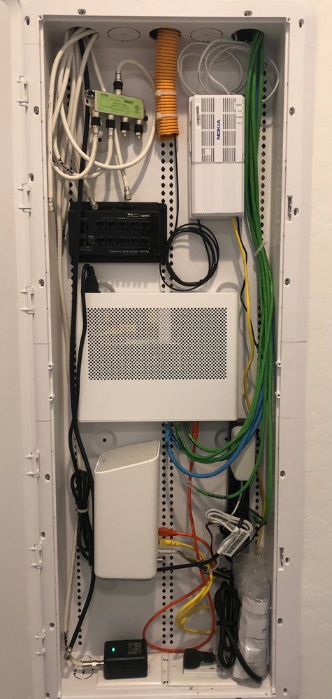

@matt_klouda I don't mind buying something, I just don't want to rent from my ISP.
Take a picture and post it here of what's connected to your Cox modem now. Then I think I can get you a good solution.

@matt_klouda Matt, is the ICX-7150-C12P capable of functioning as an Internet gateway?  Does it do NAT?  Does it support DHCP server? Nobody is training the people who set these up how to use the ICX-7150-C12P as an Internet gateway, just as an L2 switch and PSE.
BTW - that looks like the C12P in the picture.
