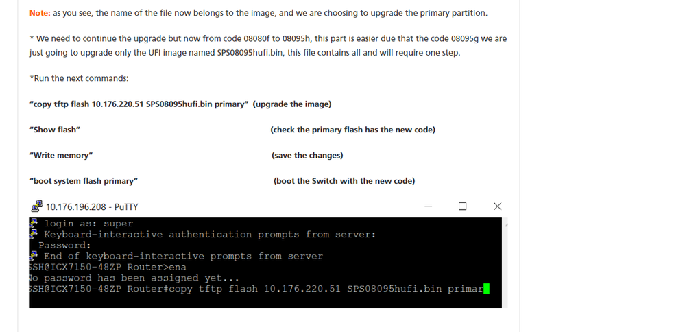

Since you are on higher version you dont need to install the 8080f version you can go ahead and install the 8095G firmware version.
You can start from this step:
From the USB guide it will be from step "20" as reference
