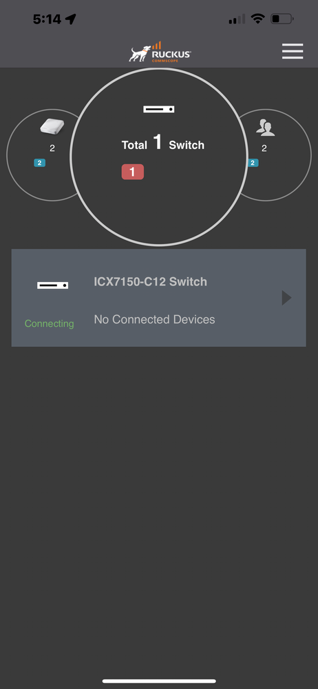

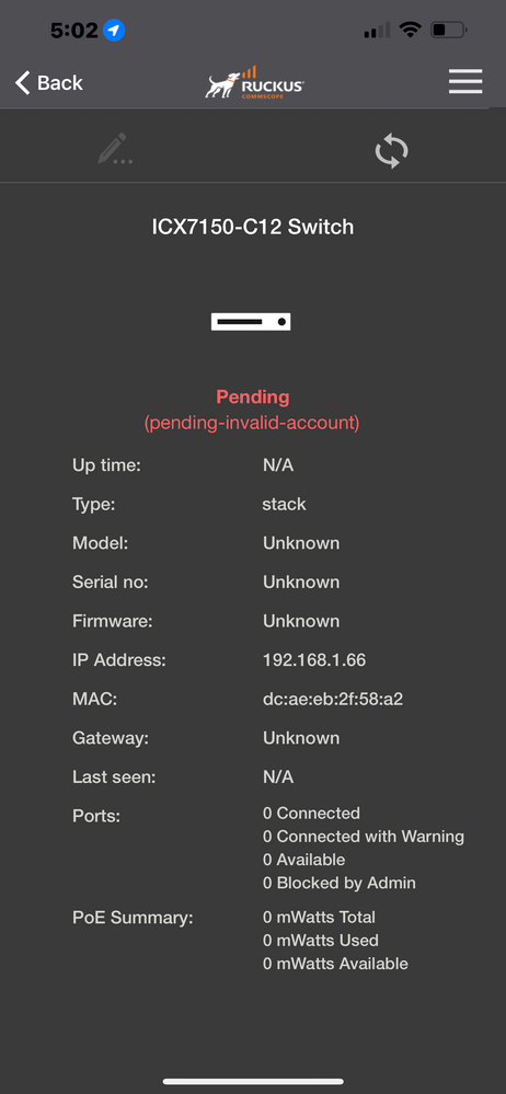

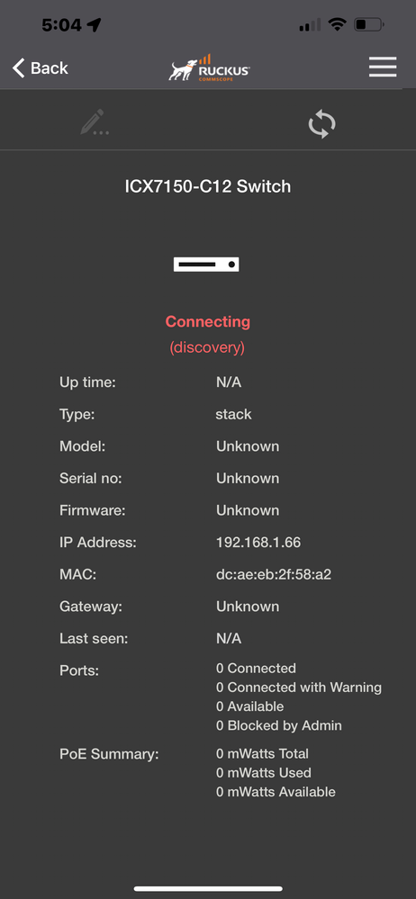

Good evening I have done what I could to the best of my ability and still I can not get this **bleep** switch to work. You stated to follow the prompts you gave me, Well **bleep** I tried and could not get any results. You all act like talking on this forum is suppose to help this is NOT working at all how come I cannot talk with w real person. This is very upsetting and as of Friday I got WROTE UP BECAUSE THE **bleep** SWITH IS NOT WORKING FOR ME TO DO WORK FROM HOME. I am very disappointed and PISSED off now. I don't see how this forum is helping I need a real person to speak with to walk me thought what is needed to get back online and at this point I don't know what to do. Here are some pictures below. Question at what point do you all speak with me this is also a HUGH issue when my smart home all because the switch is not working. 1st it would say pending and than connecting (discovery) and than back to pending. I NEED ANSWERS PLEASE.IMG-0833.PNGIMG-0832.PNGIMG-0831.PNG
Hi @BrownFamily2010
As we mentioned in one of our previous posts, we need the output of the commands to assist you further. Sharing the process once again below. We request you follow the same and please help us with the output of the commands.
ICX7150-C12 Router> OR
ICX7150-C12 Switch>
show version
show flash
