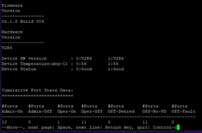

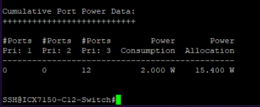

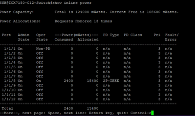

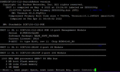

Output Results of Commands:
- show version
- show inline power
- show inline power detail
Please let me know if you need any more info from me!

04-18-2023 11:51 AM
Hi @RickoRama
As you mentioned you have one Access Point connected to Port 7. Seems like it is connected to port number 8 as marked in the screenshot below.
Could you please unplug the Access Point ethernet cable from port 8 and plug it in any 1 in 12 ports (Please refer to the 2nd screenshot below)? And check the Access Point light status and connectivity.
