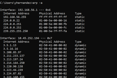

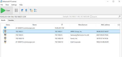

I have provided you with the steps, if you have any restrictions on your computer to download the scanner, you have to check the permissions on your computer, you can also log into your ISP router and check the connected clients, you should be able to find the IP address of your Access Points from there. Another way to find the devices connected to your network is from the CMD of your computer by running the command arp -a, there you will get a list, and you should be able to see the MAC and compare it with your APs, so you can see which is the IP assigned to per AP.
How to find the IP of your Access Points:
1:IP scanner APP:
2:from CMD in your computer:
Start>type CMD>run the command arp -a>check the MAC matching with your Access Points:

You should be able to run the scanner with no problems, because as you mentioned your Unleashed system is downs, but your ISP router should work, you can even wire a computer directly to the ISP router and download the scanner application to look for the IP address of the access point or switch, as you mentioned these happened before, and if the problem is that the switch is booting from the wrong partition causing the connectivity issues while connected to the Unleashed system, the only way to fix it will be to get access to the Switch through the web, however, it requires the IP address of the Switch, there is also an option to get access to the Switch without the IP address, but it requires access to the console using a USB to Type-C cable (the USB is plugged into the computer and the Type-C into your ICX7150 Switch) and execute commands, so let me add the two options, now if you are still having difficulties to fix your problem, you may require external help.
1:Find the IP address of the Switch, by wiring the computer directly to your ISP router, and run the scanner.
