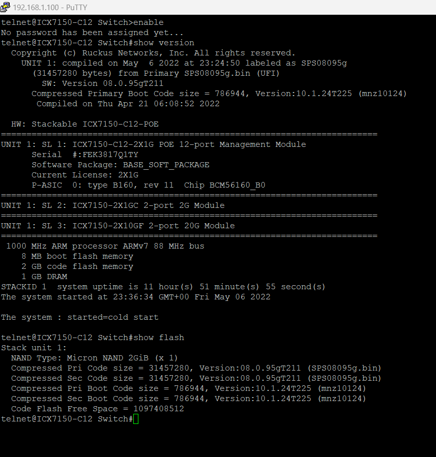

My home has  ICX7150-C12-Switch and 2 r510 ap.  The Ruckus system seems to reset randomly.  The ATT fiber router/modem is not as internet is available through ATT.  The switch does not show up in the Unleashed app but the access points do.  I connected my laptop directly to the switch but cannot get pass the login (192.168.1.100) using any of the passwords I originally got from the tech ( super &sp-admin, admin & ruckus). Called Ruckus and they say i must post to forum.  Any assistance would be appreciated.  Home built in 2019.

It is running as a switch.  Here is a shot of the session.

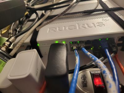

master ap  pwr, ctl, 2g, 5g are green.  all other lights off.
slave ap power and 5g are green.  all other lights off.
switch
Green lights on 1, 7, 10, 16
cables with white paint are aps, dark blue cable is att gateway, other eth cables are devices (camera, doorlock, etc)cables with white paint are aps, dark blue cable is att gateway, other eth cables are devices (camera, doorlock, etc)

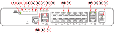

  1. Port status mode selection button   green
  2. Port link status mode LED
  3. Port speed status mode LED
  4. Member ID status mode LED
  5. USB status mode LED
  6. PoE status mode LED
  7. System Status LED    green
  8. Master/Slave status LED
  9. Software update status LED
  10. RJ-45 port 5 RX/TX activity LED (if blinking indicates RX/TX activity)  green on ap cables
  11. PoE LED
  12. RJ-45 uplink port C1 status LED
  13. RJ-45 uplink port C1 RX/TX activity LED
  14. SFP+ uplink port X1 status LED (if blinking indicates RX/TX activity)
  15. SFP+ uplink port X2 status LED (if blinking indicates RX/TX activity)
  16. Power status LED   green
  17. Cloud/On-premise-SmartZone management status LED
  18. Diagnostics status LED
