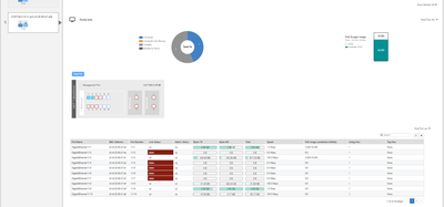

Thank you. I was able to do everything except step #2. error message shown below. I can now see the switch. My second access point is connected to port 3 and the speed on that access point is only 100mbps. Do you know why it is being limited? Also my ATT fiber gateway is connected to port 12. Port 12 is showing a warning. Do you know why?

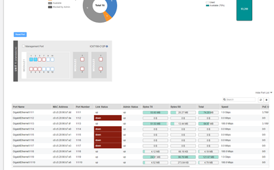

Speed drop occurs when connected to wifi on the second access point (i.e. not the master).
Speed connected directed to gateway by ethernet is above 850
Speed when connected to gateway by wifi is above 500
Speed when connected to master access point by wifi is 430
Speed when connected to second access point by wifi is 70 to 90. The speed on that access point (port 3 of the switch) seems limited to 100Mbps whereas the master is 1Gbps

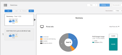

Here is a shot of the switch status from the dashboard
Screen clipping taken: 8/3/2023 8:59 AM
