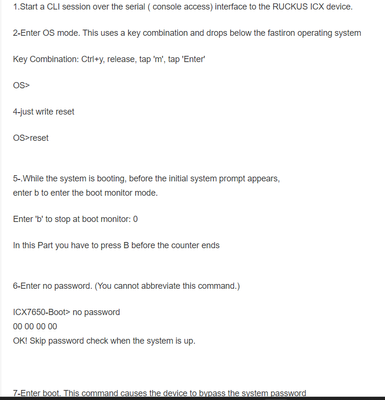

when i access the switch in serial with putty, the prompt keeps scrolling.   I am trying to use the Key Combination: Ctrl+y, release, tap 'm', tap 'Enter' but it doesn't drop to the OS prompt.  it just keeps scrolling.
Screen clipping taken: 8/1/2023 3:53 PM

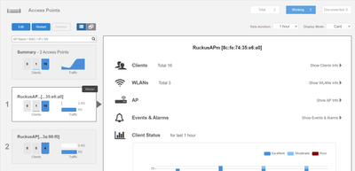

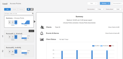

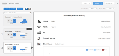

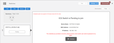

Jayavidhya. I can log into the unleash app and the unleash web dashboard using the same credentials (login admin, pw ruckus02).  The pictures below are the status of the switch and access points taken from the unleashed dashboard.  I can log into the switch with putty using a telnet or a serial connection.  Using telnet i get the prompt ... telnet@icx7150-c12switch> ... but i cannot get into the OS mode using the instructions below.  using the serial connection i cannot get a steady CLI prompt.
This the the instructions i an using:
Screen clipping taken: 8/2/2023 9:01 AM

Screen clipping taken: 8/2/2023 9:47 AM
Screen clipping taken: 8/2/2023 9:54 AM
Valued Contributor III
Hi @ajc
Thanks for the response.
1. While upgrading the switch to latest version, you have upgraded to the code 8095k instead of 8095g. So please perform an upgrade to the code 08095g UFI and upgrade both partitions with the switching code file named SPS08095gufi.bin using the below guide.
2-Make sure the management approval is enabled
https://docs.commscope.com/bundle/unleashed-200.9-onlinehelp/page/GUID-A887C55E-6973-4496-9413-302E8...
3- Also please try to enable LLDP/RSA protocol on the switch using the below commands.
Device>enable
Device#config terminal
Device(config)#lldp run
Device(config)#crypto key generate rsa
Edit the current password and username
device(config)# username super password pass
Where the username is ’super’ and password ‘pass’
1-Hit Add on that dashboard
2-Put the IP address of the ICX switch
3-Username and password for Switch authentication that we created
https://docs.commscope.com/bundle/unleashed-200.9-onlinehelp/page/GUID-30C6694A-6AEE-4DF8-9459-1AB18...
To sync the data, it will take us a while, so after a couple of minutes the switch should be in connected state.
