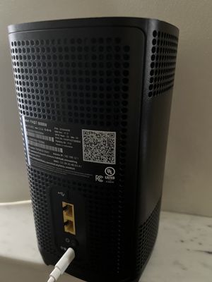

Thank you, but can you PLEASE tell me if I should first connect the switch to My T-Mobile gateway tower with an internet cable???? Otherwise where is the switch going to get internet?
also is there a LINK where I can check the switch status and what is is connected to ?
PLEASE reply to all my questions in one message, I’ve been texting back and forth for the past 3 days, and I’m still with NO internet. I WISH I can speak to someone on the phone, we could have resolved this in 10min, now it will take 10 days 😖

Hi @Btissam
Sorry for the inconvenience.
To connect to internet the modem and a router must be connected to one of the 12 ports of the ICX 7150-C12p switch.
Note: It can be a 'modem' and 'router' or 'Modem router combo', it does not necessarily have to be 2 separate devices, you can ask to your ISP which devices they installed at your home to be sure.
