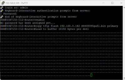

yes yes, i know, and i can't imagine you guys who are actually working to try and help those of us who have NO CLUE what we're doing really think that this is more helpful than hurtful. you know you could have fixed this for me on 12/6/22 when i started this thread.
anyway - i have done what i believe i am supposed to do and this is what's happening now.... is this right?
okay i got through the commands and said "boot system flash primary"
it said are you sure y or n and i said "y"
the putty disappeared. so i suppose now, i wait until the switch is green again, and then i run the last command "copy flash flash secondary"?
and then i'm done???

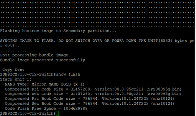

Hi @relingburg
Thank you for the response and update.
Yes, you are doing it right.
As Putty is disappeared now, please wait for some time as Switch is booting up. Once the Switch is up and running log in to putty again. And perform the command ‘copy flash flash secondary’
After it copies the image to secondary partition, just perform the command ‘show flash’ to check both primary and secondary partitions have SPS code (Switching code image) also please share the screenshot of it.
Lennar Home Community.
here's the screenshot. thanks for training me, let me know when y'all are hiring 😏
