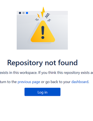

i like the 3rd option because i'm finally a little bit familiar with the gui, but when i get to the step with the link to download tftp 64, it takes me to this page:
03-09-2023 08:55 AM
i went ahead and found the download for 8095g, so that's currently downloading and says estimated time left is 45-50 min. i'll come back in 45 min and see how it's going.
03-09-2023 09:01 AM
Hi @relingburg
Please try using below link:
https://github.com/peacepenguin/tftpd64/releases
Thank you again.
