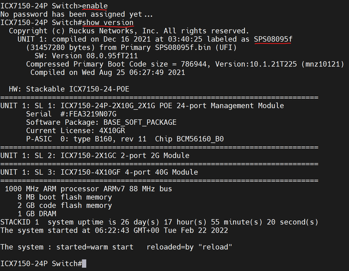

Could you please perform the below commands and share the output of each command to check if your Switch is running on an old unstable version? If so, we could upgrade your Switch to the latest recommended stable version to avoid this issue in the future.
Below are the commands: (Please refer to the screenshot below)
show version
