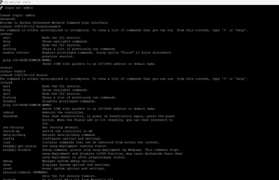

isn't this the IP address for the switch??
okay now i am here - what next? not accepting command ICX7150-C12 Router or enable
Hi @relingburg

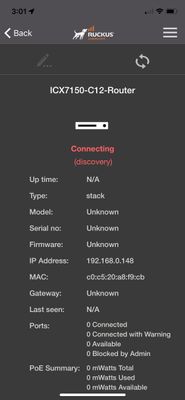

That is the CLI of the Access Point you need to find out the ICX ' IP address '
As I mentioned most possible you are not going to see the IP address since the cable is not in the right port.

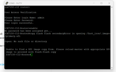

okay fernando, i'm using the cable and i got into the putty and this is where i am. can you please help me with what to do next.
