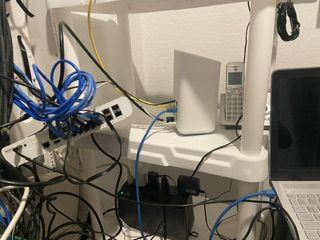

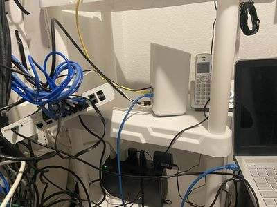

Hi @Mars55
Could you please provide an image/photo of where you have connected the cables to perform software recovery of the Switch? (Physical setup) like the following example:
- Mark as New
- Bookmark
- Subscribe
- Mute
- Subscribe to RSS Feed
- Permalink
06-14-2023 11:57 AM
The usb C cable plugged into laptop. Ethernet plugged from internet router to laptop. Pics attached.

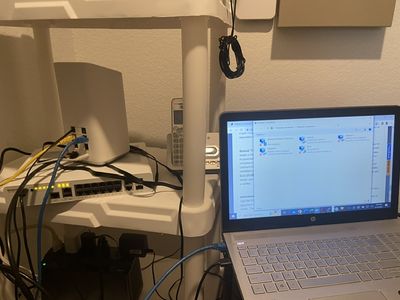

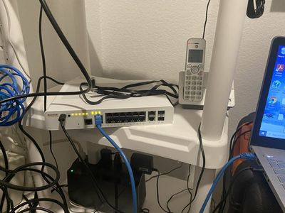

Hi @Mars55
As I could see from the picture you shared, for software recovery we need to plug in only 2 cables and a power cord to the Switch. Type-C to USB and an Ethernet cable. Please unplug all other cables. As you have used an ethernet cable from the Router and the Laptop/PC. Please connect an ethernet cable from the Management port of the Switch to the Laptop/PC and try to perform software recovery once again. Please refer to the below pictures for connection setup.
Please perform software recovery once again and share the screenshots if you are getting any errors or are stuck at any point in the software recovery process.
- Mark as New
- Bookmark
- Subscribe
- Mute
- Permalink
06-15-2023 07:41 AM
When I left connection in the below photo I received the attached boot error message
When I connected as instructed the Ethernet cable did not appear see photos
the Ethernet appears when I plug from internet router to laptop see photos
Switch is still not working. What else do I do?
