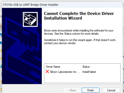

06-29-2025 02:37 PM
Adding image of USB driver "Silicon labs" not working
