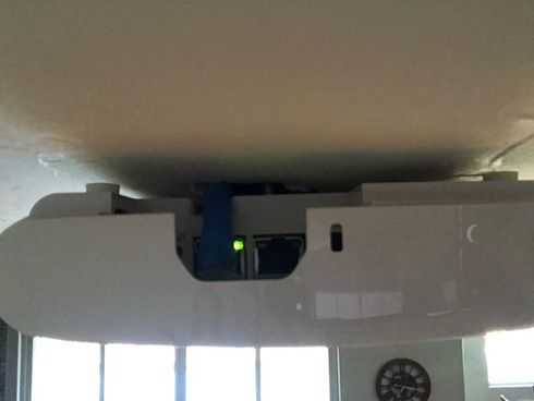

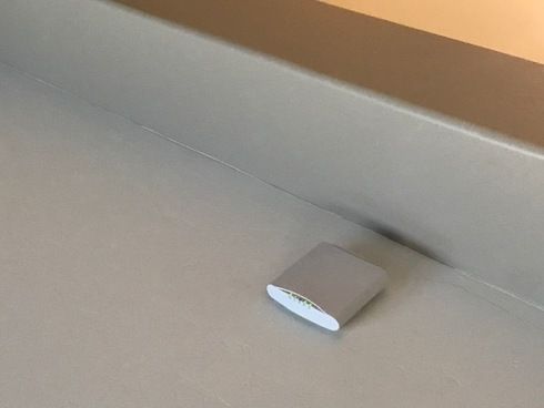

I'm going to try to attach a couple of pix of my ceiling-mounted AP here. If this works...
In the first photo (which looks like it came out upside-down, sorry about that!), notice my issue with seeing the backside of the AP --- it's mounted too close to the ceiling beam behind it, so I can't get my head/eyes up there to see much. So I got more creative & I stuck my smartphone camera up in there to get the second photo. It's a bit blurry, but you can see the blue ethernet cable plugged into the back. Given the super-limited field-of-view I have through the cutout on the back of the AP cover, maybe you can image why I was attempting to remove the cover. I still don't see any way to release anything --- the smaller slot next to the larger cutout on the back of the cover is directly in front of a power port on the AP.  If this AP ever dies, I have no idea how to get it off the ceiling to replace it....
< continued in next post... >
Image_ images_messages_5f91c451135b77e247a2051e_72bdcb355053f45470bca7a8fb003542_RackMultipart20190923417741evf-847e67ca-ac23-4fbd-a3e5-afe816d07e03-1523259575.jpeg1569252228
Image_ images_messages_5f91c451135b77e247a2051e_277c4435e6077d0d09ff8608c7e06661_RackMultipart20190923303101pz2-b080b451-ea46-486d-b960-8ac39244d8a3-1638280098.jpeg1569252253
To remove the access point from the mounting posts, look for a small hole in the side of the access point to insert a paperclip.  The paperclip will release a spring loaded catch mechanism.  While pressing the paperclip into the hole to release the cach, slide the access point along the mounted surface.  This will slide the mounting posts into the release position of the groves and the access point will disengage from the mounting posts, allowing the access point to drop from your ceiling.  The mounting posts for ceiling mount are typically small screws with the heads engaging a grove in the access point.  When replacing the access point, also use the paperclip to release the spring loaded cache mechanism to allow the heads of the mounting posts to slide past them in the far end of the grove.

So, long story short, I don't see any sign of an additional ethernet cable pulled to the AP. If there was a big enough advantage, I might consider going up in the attic crawlspace and trying to drop-in another cable.
A follow-up on the question about "cryptic" client device names shown on the AP. I suspect that some of these unknown clients on the AP are going to be little gizmos that don't provide any way to log-in.  I was hoping that there was some way, other than maybe unplugging a device and watching for something to disappear from the AP client list, that I could associate one of the these mystery clients with a physical device. For example, I think the AP will show me a MAC address for every client, but then I am unable to find any MAC info indicated on the individual devices....
From the photos it seems to be one cable only. Yeah if you want the ruckus to act as a gateway router you should have two cables running into it which would simplify things for you. Note when running in gateway mode your max WiFi devices that it can handle is 100. If running in standard AP mode it can handle up to 500 WiFi devices . If you don’t want to run a 2nd cable you can do something similar as now. However you would get a separate modem and separate router such as edgerouter x.
