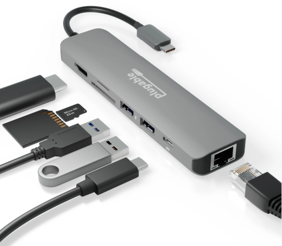

Using a Windows laptop is recommended for the Software Recovery process. You can connect the cables through an external Ethernet adapter (please refer to the screenshots below).
Let me know if you have any questions or need further clarification.

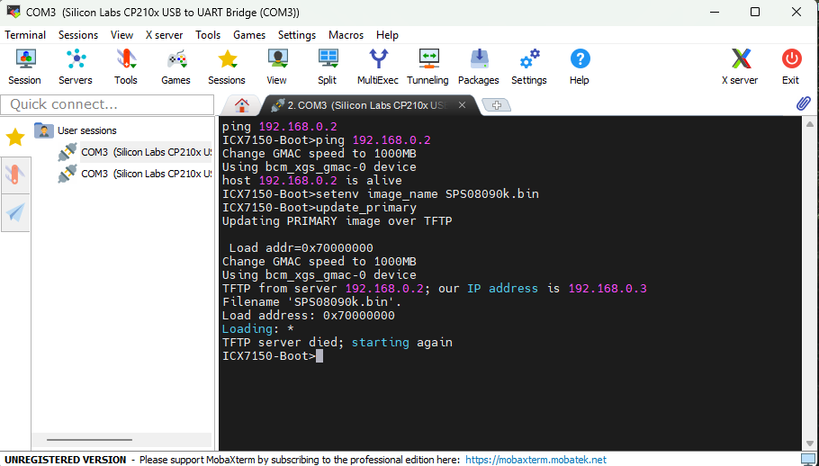

OK, I had to go buy an adapter.  Once I got connected to both USB-C and ethernet, I tried again.  I was able to get through the step C where I was able to test the connection and received an "alive" ping.  However, when I went to Step D "Performing Software Recovery", I got an error after "Loading: *" that the "TFTP server died; starting again".  At which point it goes back to the ICX7150-Boot> prompt.  Next suggestion?

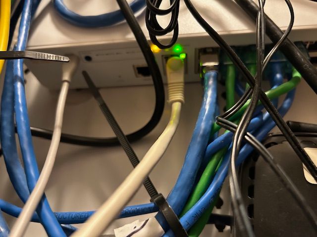

Could you please check the current light status on the Switch?

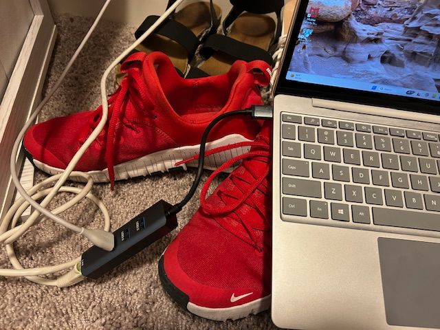

If there is no change, kindly provide a screenshot of the error message you are seeing. Additionally, please share a picture of the Software Recovery cable connections between the Switch and your Laptop for further review.

Hello!  No change in status lights. Still one green and one orange (see pic).  Also attaching pictures of cable connections and error message.Error messageError messageSwitch lights and cablesSwitch lights and cableslaptop connectionlaptop connection

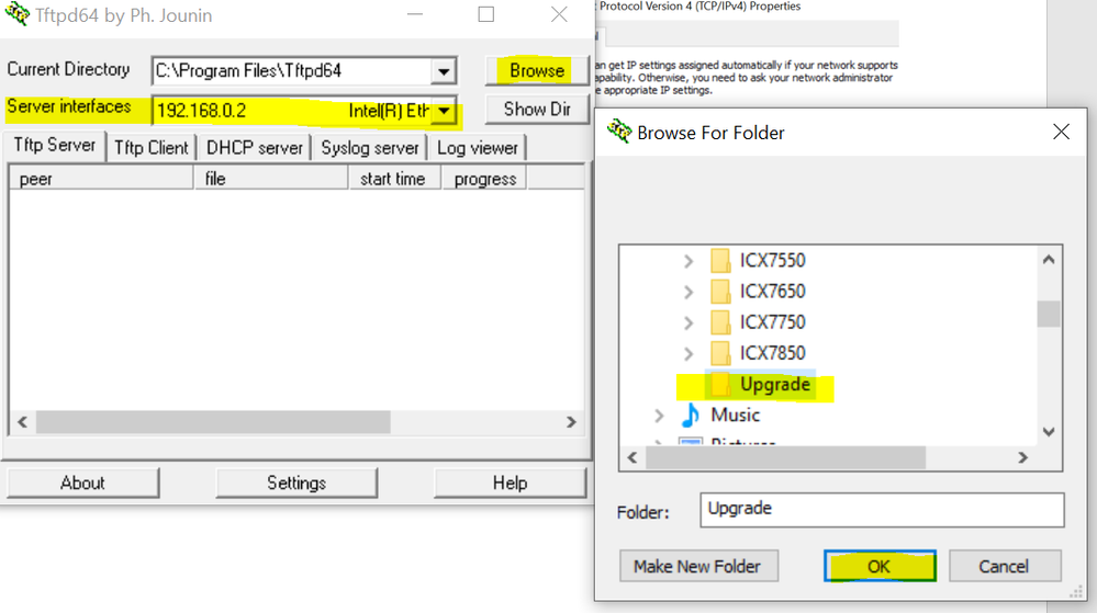

Apologies, the TFTP part is missing in the guide. We will update it shortly.
Please follow the steps below.
Please download the Upgrade folder and Tftpd64-setup from the mentioned Google Drive link. Install the Tftpd64-setup software and follow the steps below.
https://drive.google.com/drive/folders/1DdepOpf6i1csg9lC8BSt6OVGiBqwHJxe
1. Now let’s prepare your TFTP server:
Start>type TFTP>Open
A: Select the path with the folder you have created named Upgrade:
Hit browse>download>Upgrade>OK
B: Select the server interfaces as the IP address you configured for your computer:192.168.0.2
Scroll Server interfaces>choose the one you configured statically on your computer
A screenshot of a computer
Note: after configuring the TFTP server Application, this one must remain open during all process.
