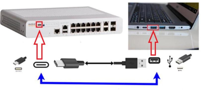

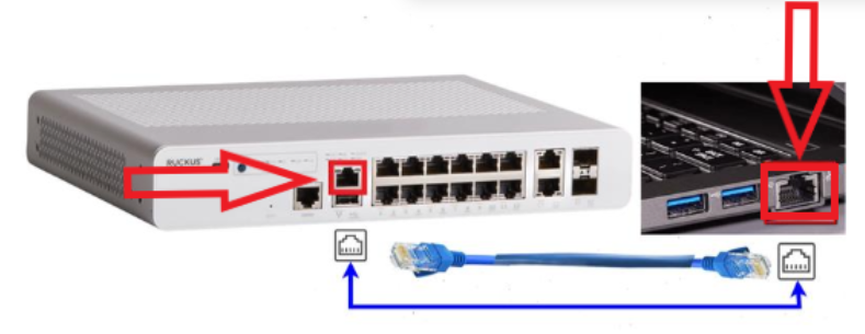

Based on the information provided, it appears that you are encountering issues with the RUCKUS ICX-7150-C12P Switch stuck in boot mode, and you are trying the Software Recovery process.
Could you please share a Picture showing the Software Recovery cable connections between the RUCKUS ICX-7150-C12P Switch and the laptop?
Please let me know if you have any other queries.
I don't have permission to upload images, but I am connected to the USB-C in the Ruckus box and USB in my Windows computer.
Hi @gte254r
Please note that we must use 2 cables. USB to Type- C cable where one end of the cable has a USB Type-C connector, while the other end has a standard USB (Type-A) connector and an Ethernet cable with both ends of RJ-45 plugs.
Refer to the screenshots below:
Please connect both cables and try the process once again from the beginning.
Let me know if you are stuck at any point during the process or have any queries in this regard.
As you are unable to upload the pictures, please log in to your RUCKUS Account before uploading any photos/screenshots.
Unfortunately, none of my Windows PC's have an ethernet port.  I did find an adapter for my old Mac, but I was unable to find the console software needed for this fix available for Mac.
