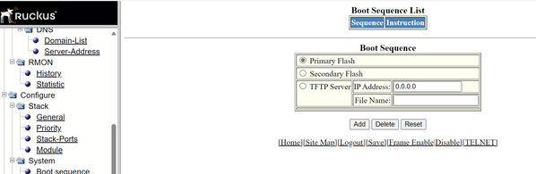

Question:  what would happen if I changed the boot sequence to secondary in the following screen shot?  Would that  boot up in switch mode?
Thanks in advance for your help!
Forgot to add the screenshot.
