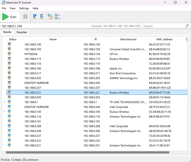

Following is a screen shot of my IP scan and it shows the switch is inactive.  Is this normal?
I am really stuck at this point......  I must be missing something??  Do I need to reset the switch and try from there?  Are you willing to do a remote session to help trouble shoot?
Again,  THANK YOU for your patience and help so far.  Please let me know your thoughts.
Hi @jeff_schultz
Could you please try to access the IP address highlighted in the below screenshot and see if it’s an Switch IP address?
Please check and confirm.
