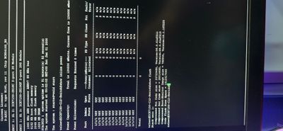

Hi all  i believe i have an icx7150 switch going to a r510...I think. The router is mounted to my vaulted ceiling. But a couple days ago our spectrum internet went out and the switch appears to be working fine both LEDs are green but the router on the ceiling has no power. It never came back on.  I've tried rebooting it a dozen times power cycling it a dozen times and nothing has worked. I also don't know where the POE cable goes since I do not see any ethernet cables coming into my electrical box from the ceiling.

Hello I believe i am in the command prompt section through Putty im using windows and im not sure where to go from here
I noticed under inline power its showing all off

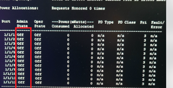

Hello @Jerry9491 ,
From the screenshots you shared, I see that the PoE is disabled on your Ruckus ICX-7150 Switch.
To fix this issue and enable the PoE on the Switch, please perform the commands on the CLI:
Switch>enable
Switch#configure terminal
Switch(config-mif-1/1/1-1/1/12)#inline power
Once you perform the above commands, all ports should be On, and Access points should get the power.
Once the RUCKUS ICX-7150-C12P switch ports come online, it should fix the issue.
