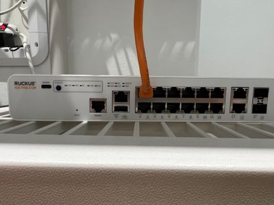

Good Morning
This morning the switch has stopped working. The power is plugged in, the power cable is securely plugged into the back of the switch. None of the information light are light on the front.
Hi @wlobbjr
Could you please provided us the pictures that shows that the ICX 7150-C12P is plug in an outlet or power source  and the front of the lights ?
Best Regards
