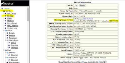

Hi @wlobbjr
The flash information will display what you have per partition, however you are still booting from secondary, you can check by clicking on Monitor on the left >device
click on Monitor on the left >device
Yarenis Hernández.
