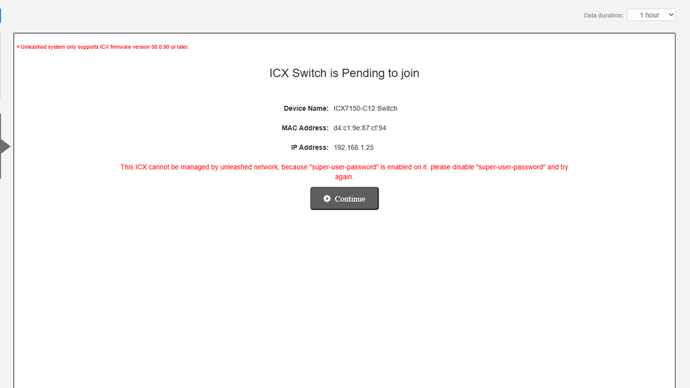

07-02-2025 03:20 PM
was able to login into the GUI but while trying to connect to it on the unleashed page I got this error.

07-02-2025 03:20 PM
07-03-2025 06:09 AM
Hi @Ihavenoideawut2 ,
Before we can help, we need to check which version the Switch is currently running.
As you have access to CLI, please enter the below commands once you log in to CLI and share the output.
show version
show flash
