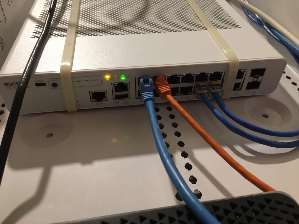

Could you please let us know if your RUCKUS ICX-7150-C12P Switch still with an Orange/Amber light on SYST and a Green light on PWR like below example in the picture?

No change as indicated by the photo. STST = Yellow. PWR = Green.

As you mentioned there are lights on PWR and SYST, if there is an amber/orange light on the "SYST" and a green light on the "PWR" on the Switch (as it is in the below picture). Meaning the Switch is stuck in the boot mode.
Basically, due to the power outage/ power spike, the switch went to a state that we call ‘boot mode’ that is not able to boot up properly.
