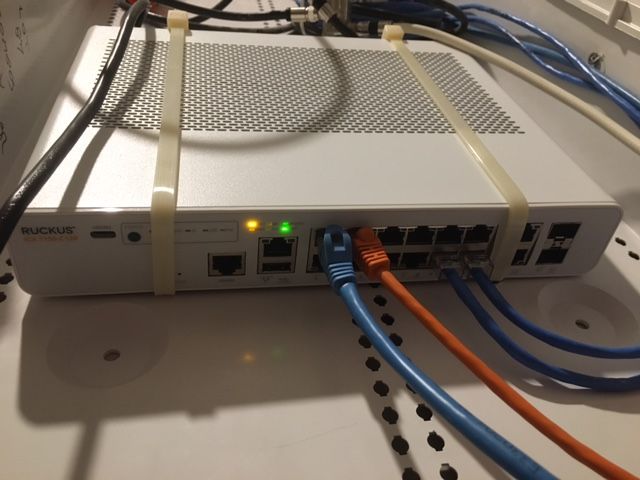

06-13-2023 02:41 PM
This is a photo of my switch.
SYST: Yellow LED.
PWR: Green LED.
No other LED lit.
06-15-2023 06:06 AM
Hi @rhrout
Thanks for the response.
Based on the description it seems that the switch has one green and one yellow light, which means that the switch is stuck in boot mode.
If this step doesn't work, we need to perform a software recovery.
Here is the quick guide to perform software recovery.
If the resetting process doesn't work, we need to perform a software recovery.
Note: after fixing the issue of the Switch been stuck in boot mode, please perform an upgrade to the code 08095g UFI and upgrade both partitions with the switching code file named SPS08095gufi.bin, so perform the software recovery using the code 08090k with the upgrade image file named SPS08090k.bin, then when the switch is back to normal upgrade to the file SPS08095gufi.bin for both partitions primary and secondary.
