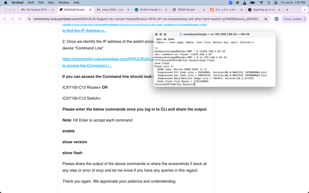

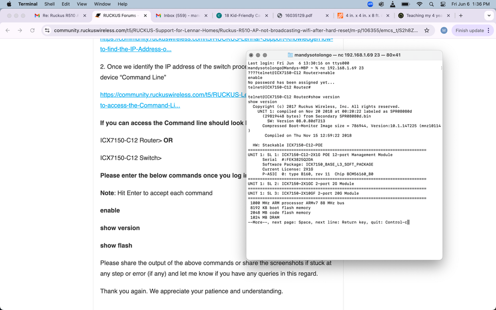

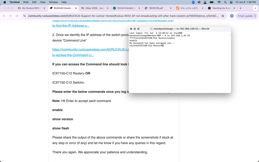

I went back to the terminal and hit enter and it did say "telnet@ICX7150-C12 Router>", so I did each of the commands that were requested.  Here are the 3 screenshots after each command.  I'm not sure if I did it right but this is what I ended up with.
MandyS
Screenshot 2025-06-06 at 1.36.02 PM.pngScreenshot 2025-06-06 at 1.36.32 PM.pngScreenshot 2025-06-06 at 1.37.51 PM.png

From the below screenshot you shared, I understand that the Switch is booted up on the secondary partition which is running on Routing code (SPR)
The Switch should run on the Switching code (SPS) to avoid these issues for Lennar home users. Due to a power outage/power spike, the Switch boots up on the other partition which may be running on a ‘Routing Code’ results in causing this issue.
